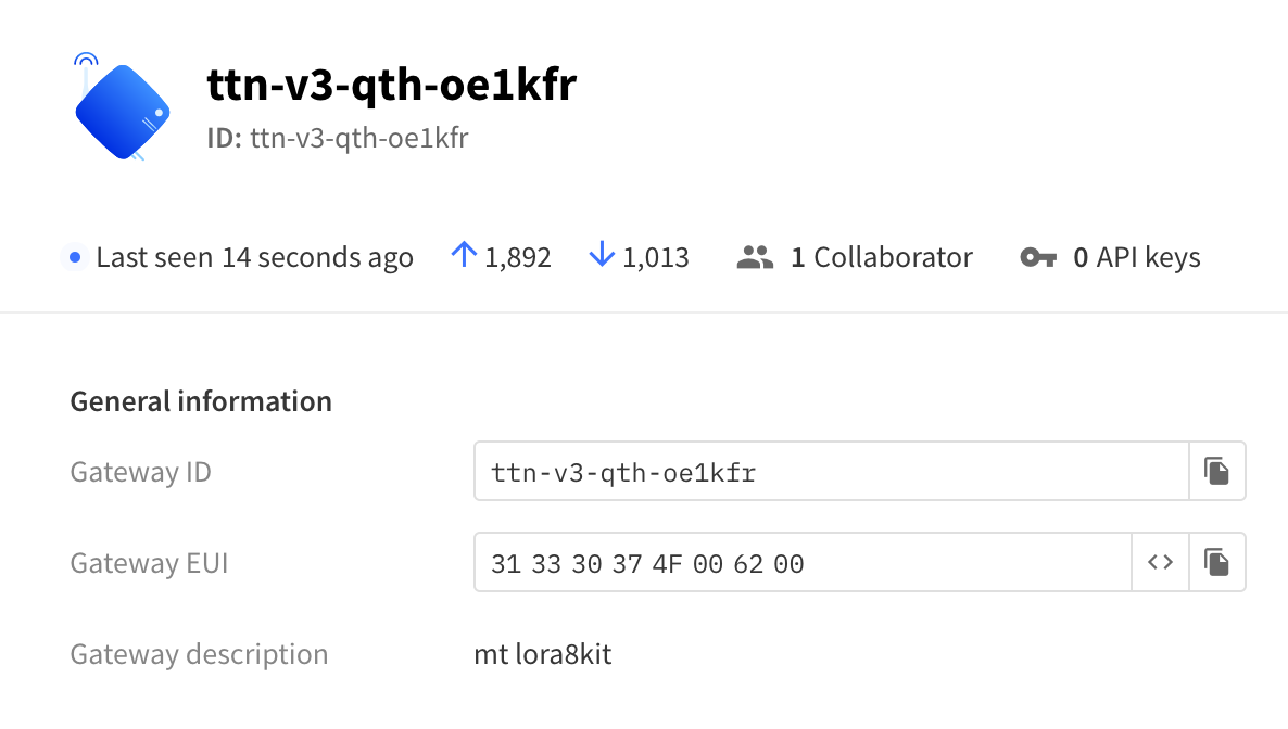

What do you mean, that have one single gateway connected to V2 and V3?
Yes with the Mikrotik Lora8 Kit and when you configure it with the winbox you can define two or more servers in parallel to forward the packets.

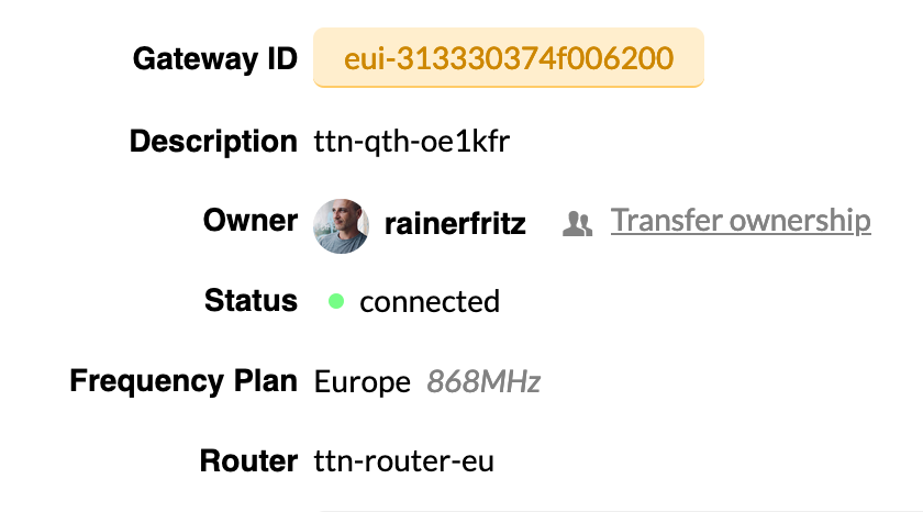

you can see in the screenshots, that it is online on both:
V2:
Bildschirmfoto 2021-02-20 um 18.23.51
V3:
Bildschirmfoto 2021-02-20 um 18.24.56

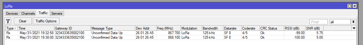

Is there a working example for configuration on both sides? I was trying to register new gateway on V2 and V3 witgout success. The V2 is OK, but has Status:unknown for the gateway and in V3 I got error: ID taken.
Here is my configuration:
[admin@mtik_LoRaGateway] > export hide-sensitive
may/31/2021 19:29:02 by RouterOS 6.48.3
software id = BS0G-I4NA
model = RBwAPR-2nD
serial number = C0220B14ED28
/interface bridge
add name=bridge1
/interface wireless
set [ find default-name=wlan1 ] antenna-gain=0 country=no_country_set frequency-mode=manual-txpower mode=
station-pseudobridge ssid=MikroTik station-roaming=enabled
/interface ethernet
set [ find default-name=ether1 ] advertise=10M-half,10M-full,100M-half,100M-full,1000M-half,1000M-full
/interface list
add name=WAN
add name=LAN
/interface wireless security-profiles
set [ find default=yes ] supplicant-identity=MikroTik
/lora servers
add address=eu1.cloud.thethings.network down-port=1700 name=“TTS Cloud (eu1)” up-port=1700
add address=eu.thethings.network down-port=1700 name=ttn-v1 up-port=1700
/user group
set full policy=“local,telnet,ssh,ftp,reboot,read,write,policy,test,winbox,password,web,sniff,sensitive,api,romo
n,dude,tikapp”
/interface bridge port
add bridge=bridge1 interface=wlan1
add bridge=bridge1 interface=ether1
/ip neighbor discovery-settings
set discover-interface-list=!dynamic
/interface list member
add interface=wlan1 list=WAN
add interface=ether1 list=LAN
/ip address
add address=44.150.168.221/24 interface=ether1 network=44.150.168.0
/ip dhcp-client
add interface=bridge1
/ip dns
set servers=44.150.168.1
/ip route
add distance=1 gateway=44.150.168.1
/lora
set 0 disabled=no servers=ttn-v1 spoof-gps=45.801832/15.178757/222m
/system clock
set time-zone-name=Europe/Ljubljana
/system identity
set name=mtik_LoRaGateway
V2 console:

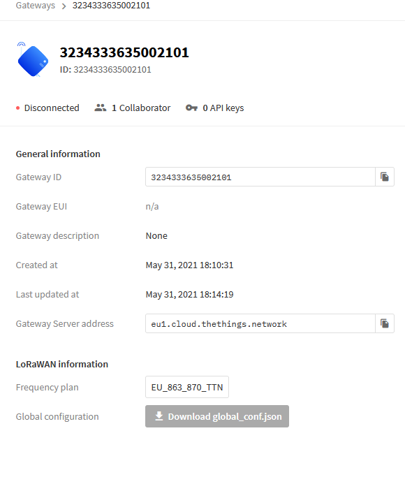

When I change last digit in ID from 0 to 1, I can register new gateway in V3. I changed server to eu1.cloud.thethings.network
but the GW is not connecting…
Is there something I have to configure additionally to the settings described here:
https://help.mikrotik.com/docs/pages/viewpage.action?pageId=8978744#wAPLR8kit-Configuration
or here:
https://www.thethingsnetwork.org/docs/gateways/mikrotik/
Or it just takes a very long time to connect?
Meanwhile during my typing some packets arrived:
But the status of the GW is “unknown”.
Should there be some log in the “traffic” for the server connection ?

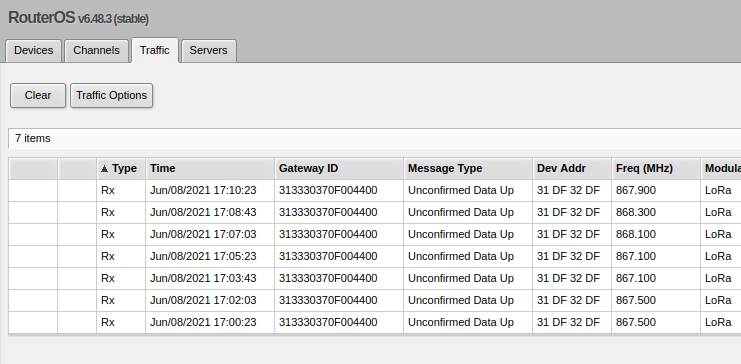

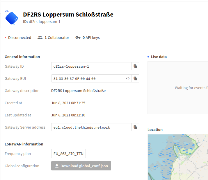

Seems not to connect… On my Mikrotik i can see the traffic, but nothing on TTN. Whats wrong. Should i have to use the “eu.mikrotik.thethings.industries” server??
grafik
grafik
What seems not to connect?
If the ERSCO2 is not registered on TTS then you won’t get anything more than some rejected traffic.
But your screen shot doesn’t show any stat messages. Your screen shot does show the address for the gateway server.
Damned. Found ist. On my Mikrotik i added .industries, but in TTN there is by default .network… omg…Sorry.
