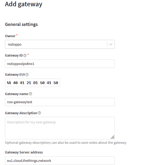

I use(d) different name on gateway ID
grafik

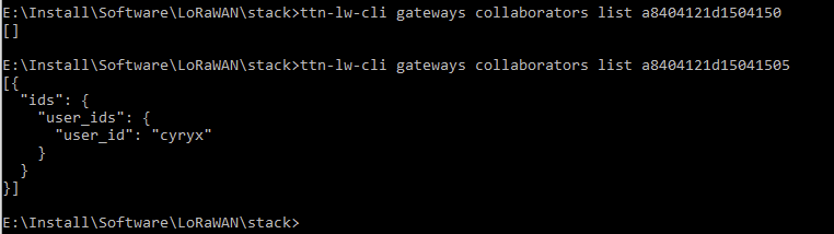

:thinking: suggest use the V3 CLI options to get the info on the GW and try to identify the registered owner - then reach out to them if poss to see if they can release as may have been a mis-type on their part…
IIRC command something like:
ttn-lw-cli gateways collaborators list [gateway-id]
Also looking at your post
Suggests you may have tried to register previously in console as the GW ID may auto-populate with the EUI if you dont set a user GW ID…did you get partway through reg process and abort or try before without success?
that is difficult to say what happend on start - I am totaly new to this.
I did point by point in documentation, but I am sure that I enterd a valid GW ID like in example below.
I got in CLI (windows)
grafik
what can i do to get it work?

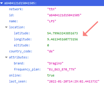

Concerning this:
The EUI ID is 8 bytes long - this is what I used for registering - the other is not a “regular” number - it is one digit longer - strange!
cyryx is Flensburg
grafik
Tried to get in contact…
OK - solved. I did not get it that the Gateway ID on Dragino is not fix (as the mac number) - I chaged it to random number and it worked. strange method!
