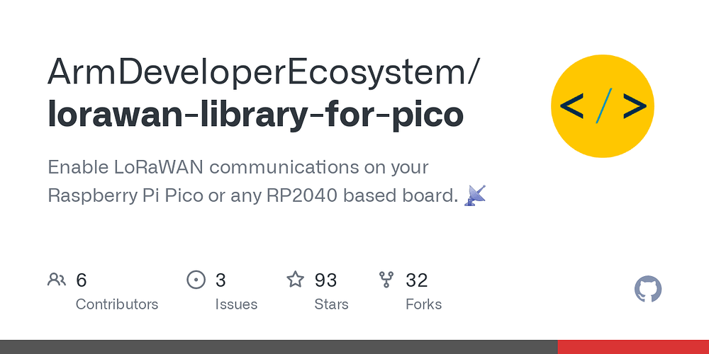

In that case he could stick with C and use an Rpi Pico with this:-
I got that to work ok as a test/investigation on TTN V3.
Build the code with VSCODE then drop the UF2 onto the Pico.
CAVEAT - Rp2040 based boards tend to hive higher sleep currents so not good for small battery operation.
