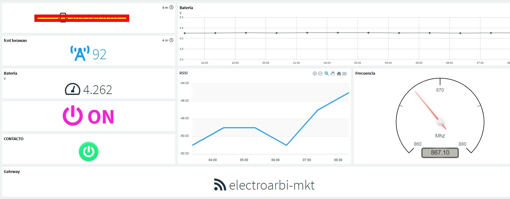

Hello @Johan_Scheepers
I have made a project as you need with an ESP32 heltec and an activation of a LATCH relay
I’m still testing but it works fine
I have it integrated with Node-red and with Thinger.iothinger
Looks very nice.

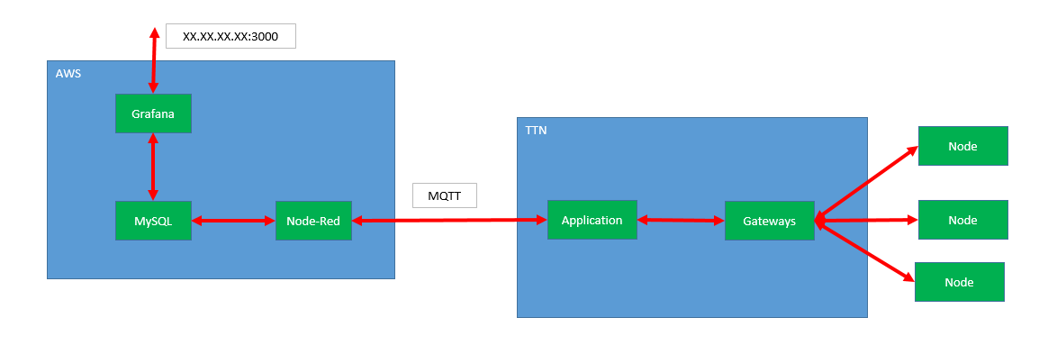

This is my basic architecture I want to use.
Just not to sure about the security risk of exposing xx.xx.xx.xx:3000 to the net. This is the port for Grafana on the AWS EC2.
