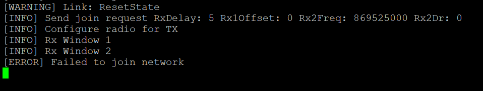

When I try to connect to join, I recive this message:
Do you Know Why?

Wrong keys? There is no gateway receiving your join request? You are not receiving the reply?
Does the device page in TTN console show a last seen value? Or is it ‘Never’?
When I try to connect the sensor to the join, I recive : “Failed to join network”, and the device page in TTN console show a last seen value ‘Never’.

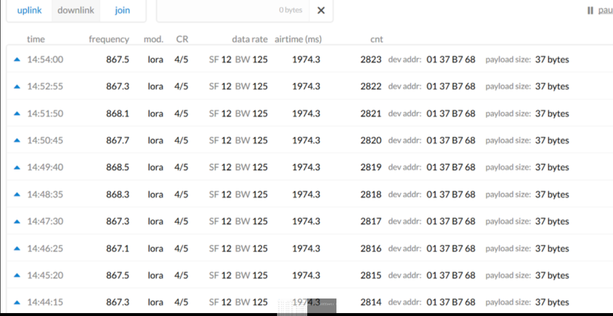

Moreover,When I see the Gateway page in TTN console, I can see that the gateway transmits information (Downlink), but that in ascending direction(uplink) there is no traffic.

You are misinterpreting the information on the page. The arrow pointing up means this is uplink traffic. If there is any downlink traffic it is hidden because the downlink filter button is grayed out.
Your screen shot does not show any join requests so if your node was transmitting at that time the gateway did not receive the request.
Is you node close to your gateway? An overly strong signal can cause reception errors which lead to CRC errors and packets with CRC errors are not forwarder by the gateway to TTN. Keep at least 3 meters (10 feet) distance between a node and a gateway.
