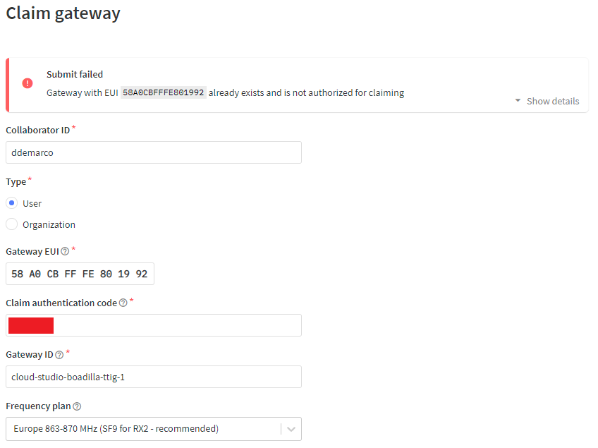

I’m experiencing exactly the same problem as @dvbahder here. Same error while claiming:
When I use the CLI to see if anyone else registered this gateway (just in case), it seems nobody did:
I tried the EUI in upper case and lower case, just in case, but got an empty array in both cases.
As @dvbahder, I’m simply trying to migrate from V2 to V3 (all devices migrated already). To the best of my knowledge, I never created this gateway myself in V3. No one else has ever had access to this gateway, it’s plugged next to me in my lab since I bought it.
I guess I’m out of options. Anyway, not urgent really, specially on Christmas Eve, but I would really appreciate some help to see what could be going on.
Thank you all, Merry Christmas, and my very best for next year!

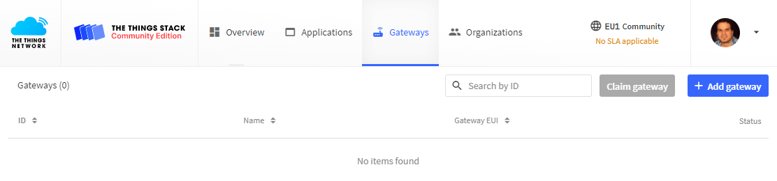

@ddemarco, you write several paragraphs without saying EXACTLY which gateway, so just to sanity check, what is is?
Hi Jeff, that’s very much appreciated. While I believe the TTIG meets all conditions in the linked article, it does not show in my console:
I certainly have the same user ID as I had in V2 (ddemarco), because I always logged into V3 using the V2 credentials.
The information you provide in the link seems totally correct, i.e. that’s the data the gateway had on V2. Based on the article, it really looks like the gateway was migrated to V3 automatically, but doesn’t show in my console. It does work, though, as I receive the traffic from all devices. Would that confirm that the gateway was migrated? If so, under which account?
Thank you!
Diego
Hi @descartes,
I do have the same user id, as I only logged into V3 using the V2 credentials. I apologize for not including the gateway EUI as text (it was part of the screenshots only), so here it goes: 58a0cbfffe801992
Based on the conditions mentioned by Jeff, I tend to think the gateway was effectively migrated, but for some reason it doesn’t show in my console (checked all three regions just in case).

It looks like someone else registered a gateway with the EUI of your gateway. Looking at the ID of this registered gateway, it looks like this was done by mistake, so I just released the EUI. You should be able to claim your TTIG now.
Hi, that’s brilliant, thank you! The claiming succeeded all right and I’m receiving data from the devices without any issues. Thank you again for your support, and all the best for 2022!

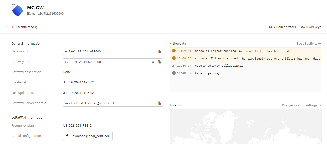

Hi everyone,
I’m experiencing the same problem and always getting the following error when I login to my account.
Error ID: error:pkg/auth/rights:no_gateway_rights
Correlation ID: 2638a37fc5ad4e12ac6b996e728eafea
“code”: 7,
“message”: “error:pkg/auth/rights:no_gateway_rights (no rights for gateway eui-2cf7f21116090001@ttn)”,
“details”: [
“namespace”: “pkg/auth/rights”,
“name”: “no_gateway_rights”,
“message_format”: “no rights for gateway {uid}”,
“attributes”: {
“uid”: “eui-2cf7f21116090001@ttn”
“correlation_id”: “2638a37fc5ad4e12ac6b996e728eafea”,
“code”: 7
Here is also a screenshot of the gateway page.
Thank you all!
