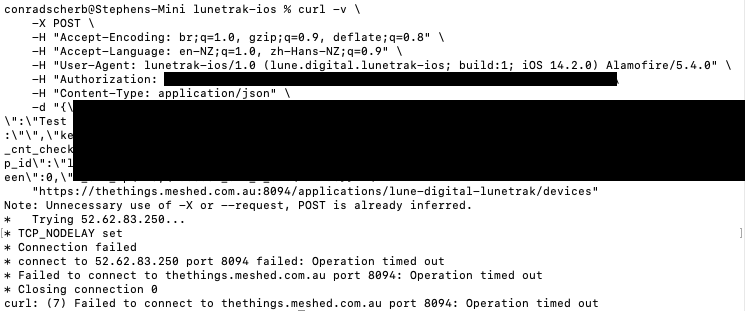

Unfortunately I am not able to connect with the Application Manager API using that url - see cURL output below. Does anyone know what you should use to make an HTTPS request to the meshed-handler region (e.g. for eu it was https://eu.thethings.network:8094/
Screen Shot 2020-12-10 at 9.08.49 AM
