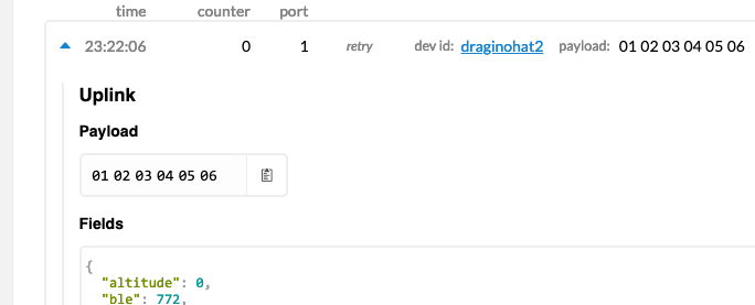

Given the above input it should send the bytes 010203040506 to TTN:
36%20AM
