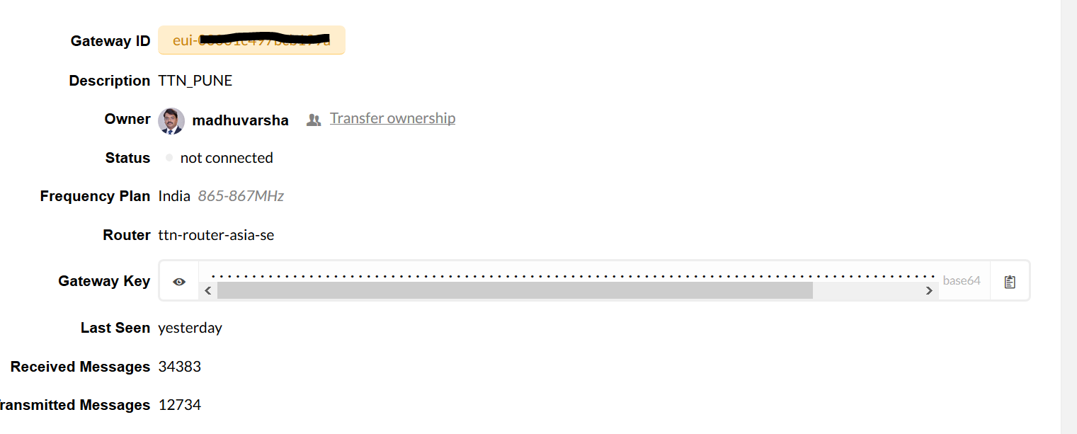

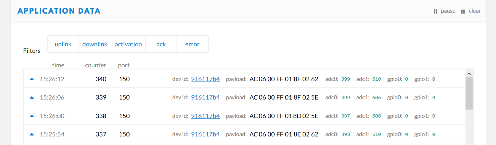

(Madhuvarsha) #17
That’s true, my gateway is showing offline since yesterday but under device data is visible.
Gateway:
Device:
