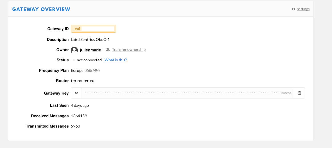

Seems that I have kind of a same problem since this date.
But mine is different as my Gateway is not seen as connected anymore
checked the installation (Gateway Laird Sentrius connected via 4G router to the net: gateway seems to push, as usual, data on the net but nothing seen on thethingnetwork administration console)
Any idea ? 17
