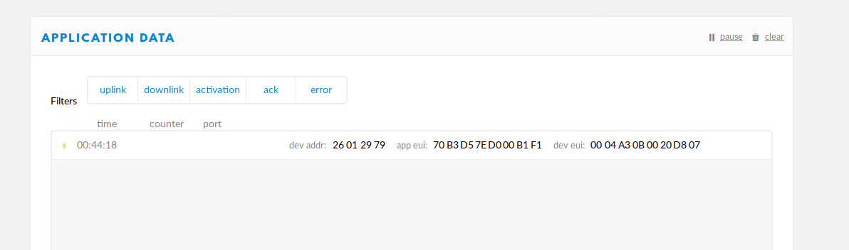

There are two gateways nearby. It always says denied, however, at what seems to be completely random - about 1 out of 20 times - it will create a new entry in the application data tab under “activation” in the TTN console, but the module still returns “denied”. :thinking:

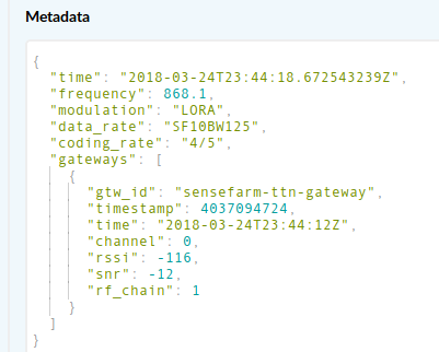

What is an acceptable/normal RSSI? What could be causing this behaviour? Lack of signal?

If TTN receives the OTAA Join packet and the EUIs and keys are okay, then such should be visible in TTN Console for each join attempt, if you have TTN Console open at the time of the join. (Or it should show an error when re-using security nonces.)
So seeing it only “very rarely” implies that your EUIs and keys are okay, but that your node is often out of reach of gateways. Also, for the few cases where you saw the activation in TTN Console, apparently the subsequent Join Accept was not received by your node, so again the node was out of reach (or not listening at exactly the right time).
I’d first focus on ensuring TTN gets the OTAA Join Request for each and every attempt. Or, test with ABP first to ensure you’re in reach.
