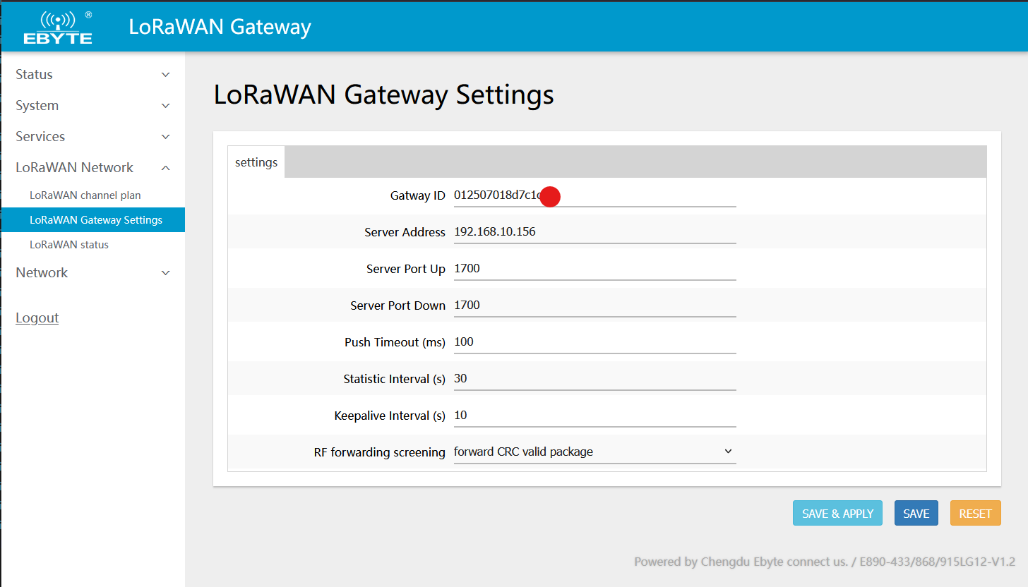

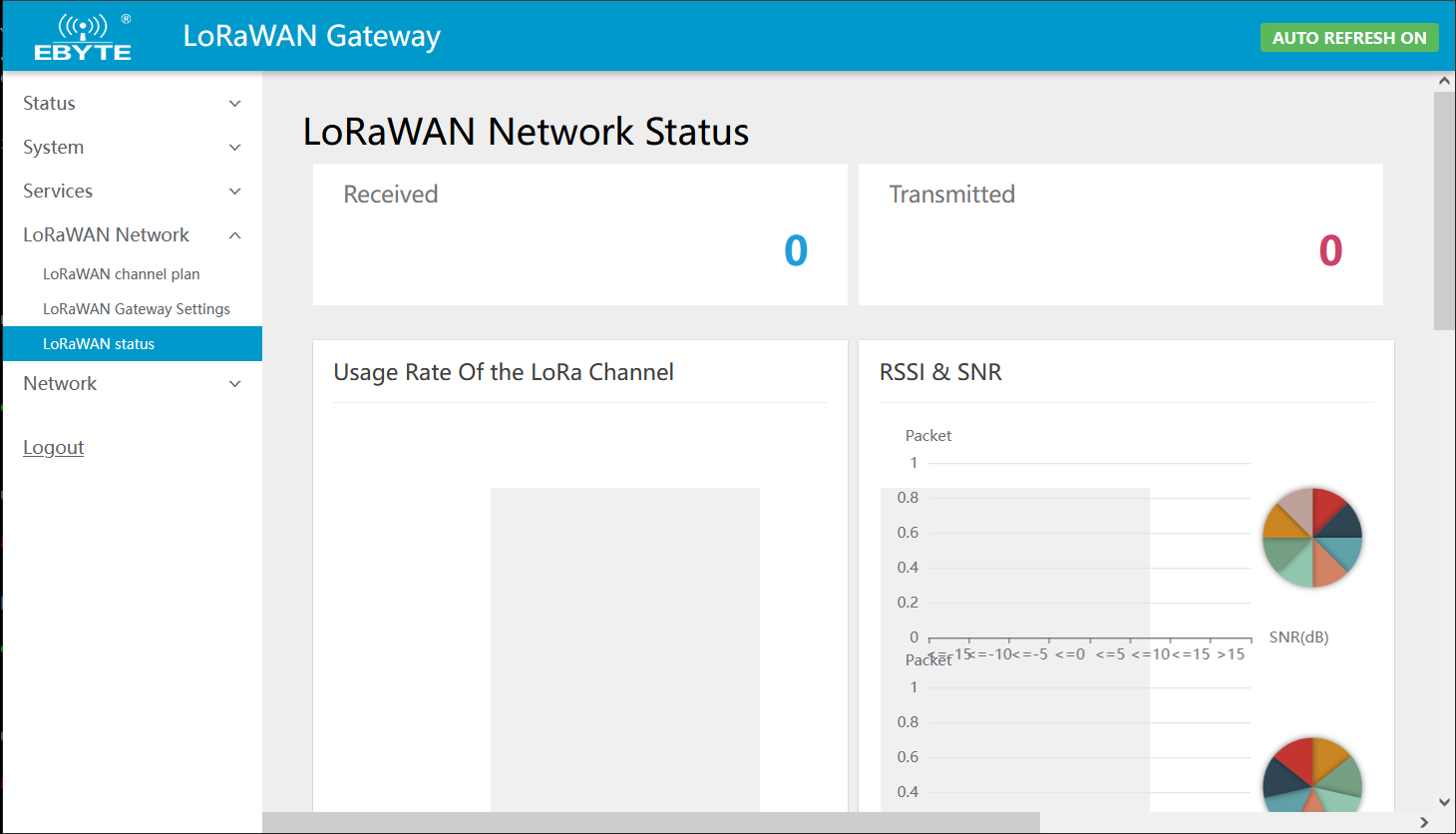

I don’t see any frames in my web UI of LoRaWAN gateway (made by Ebyte):

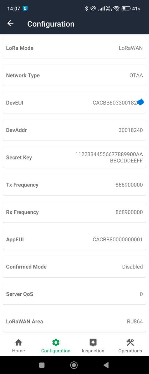

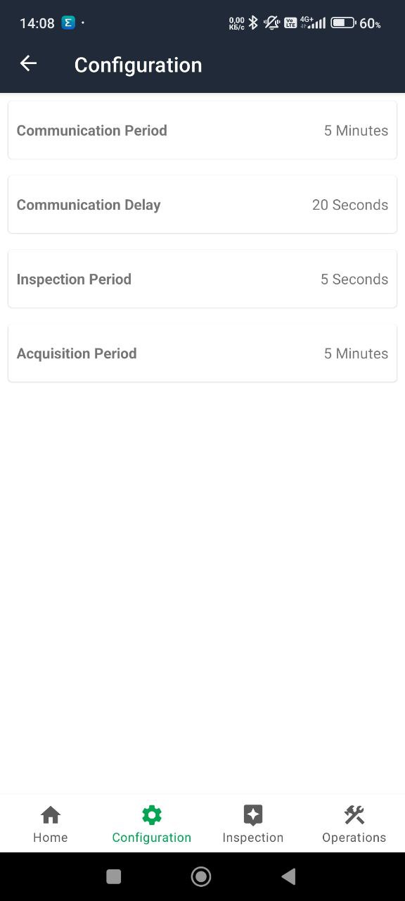

device settings:
The region is same for gateway and device, however, no frame was received or transmitted:

Blocking out the EUI’s is pointless and stops up checking online for status. You SHOULD have blocked out your “Secret Key”.

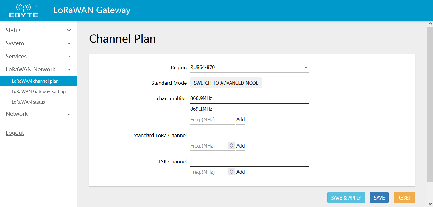

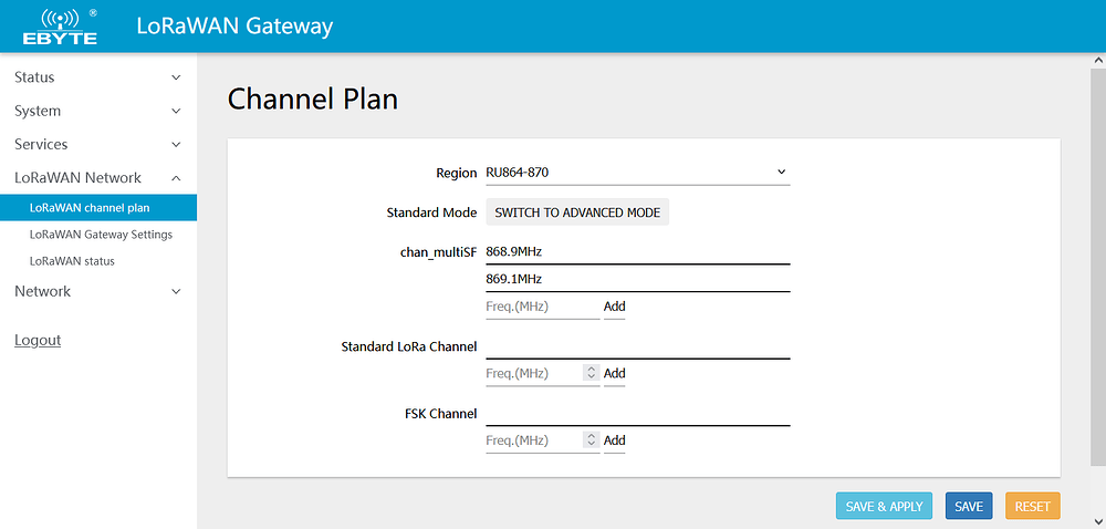

Settings for two frequencies in the gateway and a Tx & Rx frequency entry for the device raise suspicions that these aren’t really very compliant. There should be at least three, if not eight frequencies setup for the gateway.
But as you say, should actually show something in the gateway.
If Chirpstack sent a downlink, was it a Join Accept? Which may have changed the frequencies in a way that stopped the unknown device from working.

I can change secret key
actually there is advanced mode in gateway’s GUI, where many frequencies can be found
