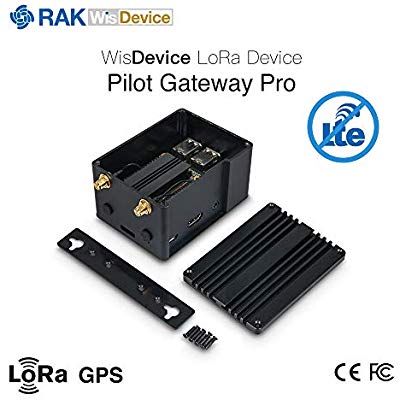

Well, I considered all that has been shared. Thank you. I have learned a significant amount in just 2 weeks.
The fact that the LG01-P is single channel (which initially did not bother me but I know more now), only receive and will always only do ABP. And that their own spec says it will lose 60%.
I have chosen a different low cost attempt.
Basically a pre-assembled raspberry pi dyi.
Says Full LoRaWAN Stack support (version 1.0.2) hope that is current, recognize not ‘certified’
I figure this way I am not bound to a rom based solution and I may be able to bail myself out with this one. And at the end of the day I at least end up with another pi. :slight_smile:
When I consider the value of my time, am I really saving money fooling with the Dragino?
I will still let ya know what dragino say about the LG01. And if the new solution works.
You should be fine with that choice. LoRaWAN 1.1 support using TTN should work as well once it is implemented on the public infrastructure. Might require a software upgrade on the gateway but that should not be a problem.
