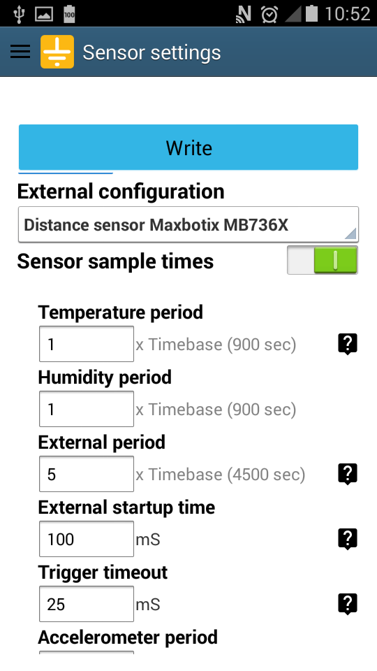

Hi everyone, I have an ELSYS ELT-2-HP with a Maxbotix ultrasonic sensor and I can’t get the ultrasonic sensor to work.
The device has been configured using the ELSYS NFC app all ok. It is joined and uplinking all ok. The uplinks report correct data for the environmental sensors, e.g.:
“temperature”: 20.8,
“humidity”: 40,
“vdd”: 3611,
“pressure”: 1005.568
Nothing from the Maxbotix at all.
I have configured the Maxbotix via the NFC app and tried both types of external Maxbotix sensor types listed and also set the timers on the external interface. See picture below for example.
Screenshot_2020-04-03-10-52-25
Nothing that I have done has caused anything to appear in the uplinks for the ultrasonic sensor. I’m very careful to make sure that the NFC app successfully writes to the device when I make changes and that the device re-starts and re-joins. It always does, all ok.
I have noted that the Maxbotix ultrasonic horn is labelled MB 7389 on the inside.
Does anyone have any insight into what I’m doing wrong or missing?
