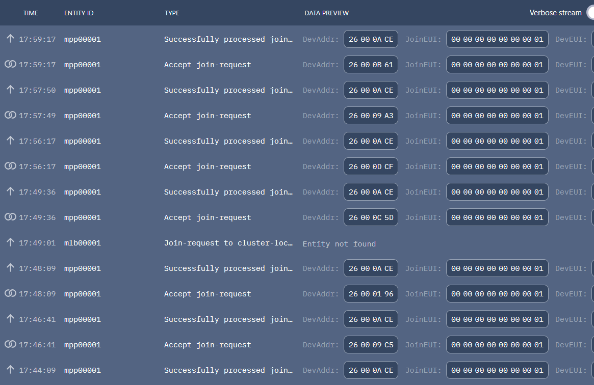

Is this the same device trying to repeat the join process or are there several devices in that grab? (As we cant see the DEV EUI we cant tell). What is the end node device? What firmware/LW s/w stack? There doesn’t appear (from this small snippet) to be a back off mechanism in play - just having the device banging away trying to join wont help (hello head meet wall! :wink: ) What does local log from end device show?
So the device initially joins and sends data? Then stops sending and reverts to trying to rejoin? How many messages before it drops off? Is it a consistent number before it falls over……
I have seen similar application live data recently for a home made device. It worked perfectly on the test bench powered by USB, but would not join when installed on site. I had a power supply issue and the device was restarting every time it transmitted.
Check your gateway logs to see if the join accept is being transmitted. That should verify that your stack is doing what it should. Then check the device.
Hi @Jeff-UK,
It’s the same device trying to repeat the join process in the previous grab. The end device is a Minew LSP01 LoRaWAN PIR Sensor using LoRaWAN 1.0.3. I do not know how to check the end node logs, I’m not sure it can log anything. I checked the gateway logs and it appears to not send any downlinks to that sensor. There is a second sensor that had trouble connecting and now it successfully sends data. This device has initially connected a while ago, transmited for about 5 hours, then tried to repeat the join process similar to this LSP01 device. I’m really confused. This second sensor is a Seat & Desk Occupancy Sensor | PIR Occupancy Sensor | Milesight running version 1.0.3. The odd thing about this sensor is when I look at the device overview I see the root keys provisioned on an external Join Server. I’m not sure how this is possible considering I’m running a single instance of the stack using the tutorial docker file.

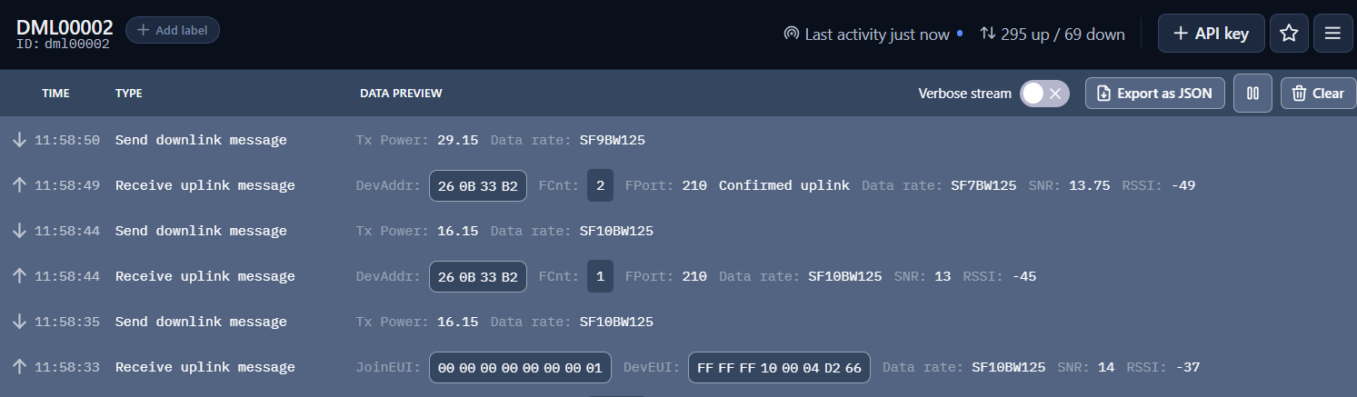

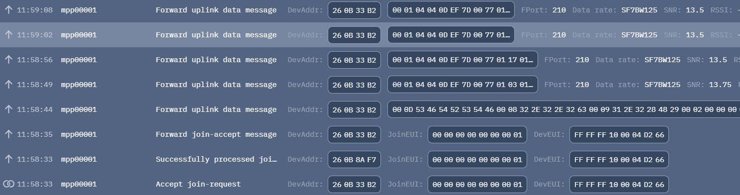

@Jeff-UK Thanks for the tips!
I registered the gateway on the TTS Sandbox and all the devices connected instantly. I set up the same gateway as a basics station similar to how I did it on my local instance. The devices were registered using the same DevEUI, AppEUI, and AppKey. So there’s definitely a problem with the method I set up my local instance.
TTS Sandbox app logs
Gateway live data for the LSP01 joining the network after being turned off
Application live data for the LSP01 joining the network after being turned off

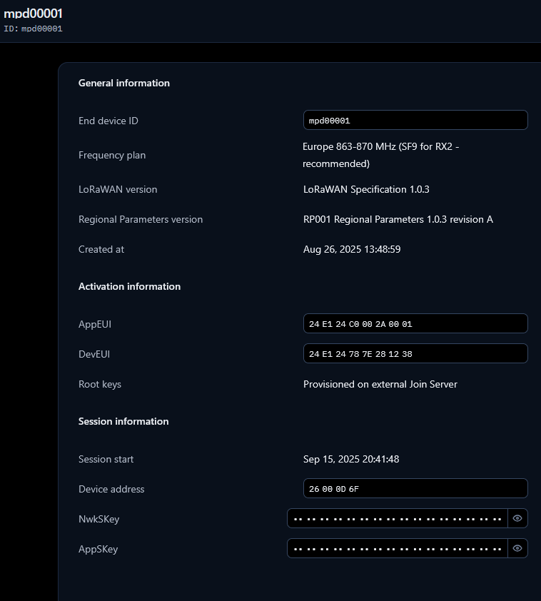

About the local instance. The working sensor stopped successfully broadcasting data around 7 hours ago, after it sent around 380 uplinks. The logs show it got disconnected, and when trying to join again there is no NwkKey specified.
MPD00001
Console logs:
  "name": "ns.up.join.cluster.fail",
  "time": "2025-09-17T09:06:17.503724606Z",
  "identifiers": [
      "device_ids": {
        "device_id": "mpd00001",
        "application_ids": {
          "application_id": "dlorawan"
        "dev_eui": "24E124787E281238",
        "join_eui": "24E124C0002A0001",
        "dev_addr": "260002A0"
  "data": {
    "namespace": "pkg/joinserver",
    "name": "no_nwk_key",
    "message_format": "no NwkKey specified",
    "correlation_id": "249cd5ba2543449ab38095e6181975ca",
    "code": 9
  "correlation_ids": [
    "gs:uplink:01K5BESD8X0ZRNKFHSMXA6E03R",
    "rpc:/ttn.lorawan.v3.GsNs/HandleUplink:01K5BESD8XG2TCQB08V6RGWP25"
  "origin": "lorawan_stack_tts",
  "context": {},
  "visibility": {
    "rights": [
  "unique_id": "01K5BESD8ZWAZVHB52V37JY7WQ"
Stack Docker logs:
DEBUG   Crypto Server connection is not available       {"cluster_role": "CRYPTO SERVER", "dev_eui": "24E124787E281238", "error": "error:pkg/cluster:peer_unavailable (CRYPTO SERVER cluster peer unavailable)", "grpc.method": "HandleJoin", "grpc.service": "ttn.lorawan.v3.NsJs", "join_eui": "24E124C0002A0001", "namespace": "joinserver", "request_id": "01K5BDMSDJAY4YDS9JEREJD4NP"}
INFO    Join not accepted       {"dev_eui": "24E124787E281238", "error": "error:pkg/joinserver:no_nwk_key (no NwkKey specified)", "grpc.method": "HandleJoin", "grpc.service": "ttn.lorawan.v3.NsJs", "join_eui": "24E124C0002A0001", "namespace": "joinserver", "request_id": "01K5BDMSDJAY4YDS9JEREJD4NP"}
WARN    Finished unary call     {"duration": 0.0009, "error": "error:pkg/joinserver:no_nwk_key (no NwkKey specified)", "error_correlation_id": "5e62d7b4401d40978e7508d5449ad2bf", "error_name": "no_nwk_key", "error_namespace": "pkg/joinserver", "grpc.method": "HandleJoin", "grpc.service": "ttn.lorawan.v3.NsJs", "grpc_code": "FailedPrecondition", "namespace": "grpc", "peer.address": "pipe", "request_id": "01K5BDMSDJAY4YDS9JEREJD4NP"}
INFO    Cluster-local Join Server did not accept join-request   {"bandwidth": 125000, "data_rate": "lora:{bandwidth:125000  spreading_factor:10  coding_rate:\"4/5\"}", "dev_addr": "26000622", "dev_eui": "24E124787E281238", "device_channel_index": 1, "device_uid": "dlorawan.mpd00001", "error": "error:pkg/joinserver:no_nwk_key (no NwkKey specified)", "frequency": 868300000, "grpc.method": "HandleUplink", "grpc.service": "ttn.lorawan.v3.GsNs", "join_eui": "24E124C0002A0001", "m_type": "JOIN_REQUEST", "major": "LORAWAN_R1", "namespace": "networkserver", "phy_payload_len": 23, "received_at": 1758098777.5219033, "request_id": "01K5BDMSDHRMZQA6N7C3N6CC34", "spreading_factor": 10}
DEBUG   Publish events  {"bandwidth": 125000, "data_rate": "lora:{bandwidth:125000  spreading_factor:10  coding_rate:\"4/5\"}", "dev_addr": "26000622", "dev_eui": "24E124787E281238", "device_channel_index": 1, "device_uid": "dlorawan.mpd00001", "event_count": 4, "frequency": 868300000, "grpc.method": "HandleUplink", "grpc.service": "ttn.lorawan.v3.GsNs", "join_eui": "24E124C0002A0001", "m_type": "JOIN_REQUEST", "major": "LORAWAN_R1", "namespace": "networkserver", "phy_payload_len": 23, "received_at": 1758098777.5219033, "request_id": "01K5BDMSDHRMZQA6N7C3N6CC34", "spreading_factor": 10}
WARN    Finished unary call     {"duration": 0.0023, "error": "error:pkg/joinserver:no_nwk_key (no NwkKey specified)", "error_correlation_id": "5e62d7b4401d40978e7508d5449ad2bf", "error_name": "no_nwk_key", "error_namespace": "pkg/joinserver", "grpc.method": "HandleUplink", "grpc.service": "ttn.lorawan.v3.GsNs", "grpc_code": "FailedPrecondition", "namespace": "grpc", "peer.address": "pipe", "request_id": "01K5BDMSDHRMZQA6N7C3N6CC34"}
DEBUG   Server ping sent        {"endpoint": "/traffic/{id}", "gateway_uid": "direk-dml00002", "http.method": "GET", "http.path": "/traffic/eui-AC233FFFFEC1D37C", "namespace": "web", "peer.address": "172.18.0.46:42886", "peer.real_ip": "82.16.22.230", "remote_addr": "172.18.0.46:42886", "request_id": "01K5APFAN6QZKP3C8Z4TDK1FNM"}
Device Overview:
