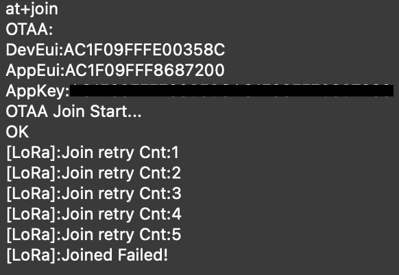

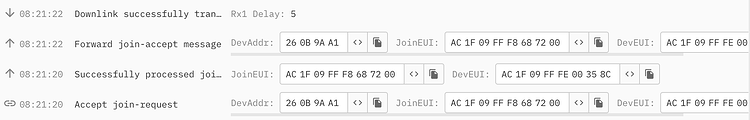

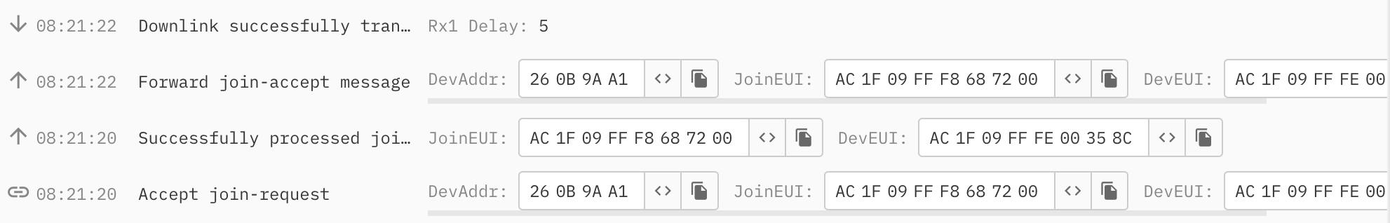

I have a RAK7200 and I’m attempting to join the network. I’ve followed the manual they provide. However, when I send the join request (at+join) it returns joined failed after five attempts. In the live data tab, I can see four events:
  • Accept join-request
  • Successfully processed join-request
  • Forward join-accept message
  • Downlink successfully transmitted

Really very critical legal & FUP note: Continuous retries resulting in downlinks will breach the 10 downlinks a day - you used up 5 in the screen shot - please do NOT post text as screen shots, use the </> to format them.
