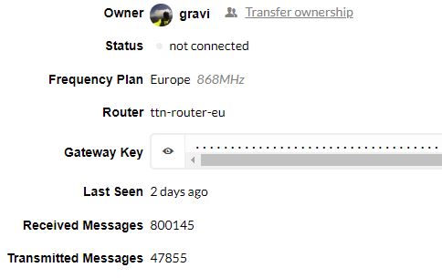

Hi
My Gateway is also in “not connected” mode for 2 days. But all applications transmit data normally on this Gateway.
CaptureTTN
Hi Jeff,
indeed your analysis seems correct, thanks for that.
Nico
