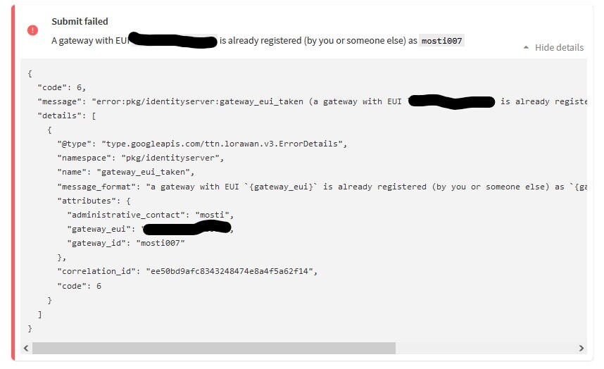

I have the same problem with my Milesight UG65.
It seems to be a big problem…if I buy a 500€ gateway it should work.
Is there any other possibility to get my gateway working with TTN without the EUI?
Thank you for your help
And it probably does - but I doubt Milesight are in a position to guarantee that someone somewhere on the internet has had finger trouble entering an EUI. This was not the doing of TTI or Milesight but is related to the user @mosti007 indicated in the error message. Have you tried contacting them via the forum?
No - and no one here other than mosti007 can help - but you could put in a request on Slack for the TTI team to look in to it.

@mosti007 is the gateway id and @mosti the user id. Unfortunately this user is not registered on the forum.
Hence Nick’s suggestion that you reach out to the TTI core team on Slack (#support channel?) as none of the volunteers or moderators on TTN Forum have access to underlying TTN main accounts.

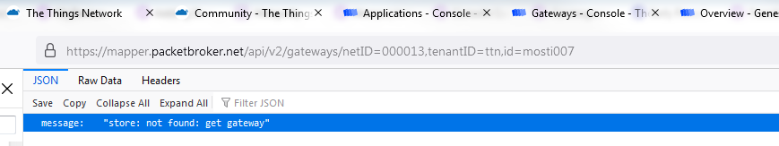

Interestingly a quick pole of an associated db suggests that GW id is not currently associated with an active GW so it maybe they (mosti) entered incorrectly then changed details and redid but didnt delete/clean up database - again TTI core team may be able to free up/clean back end db
