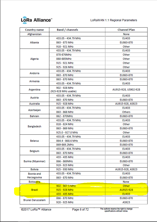

The Regional Parameters LoRaWan 1.1 on page 8 say
regional%20parametros%20Brasil
AU915 for Brasil and many more south american
