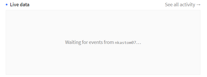

The ‘Live data’ panel of the gateway shows data. I can see an uplink message with the correct DevAddr of my end device. On the other hand, when I explore the ‘Live data’ panel of my end device I can’t see any relevant message. It’s just an empty screen. Just to clarify, the status of my end device is still “unknown”.

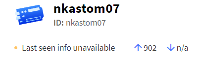

On the other hand my end device still have the status message: “Last seen info unavailable” and the live data panel is empty:
So my question is what steps do I have to do to continue my migration process? Unfortunately I got stuck.
