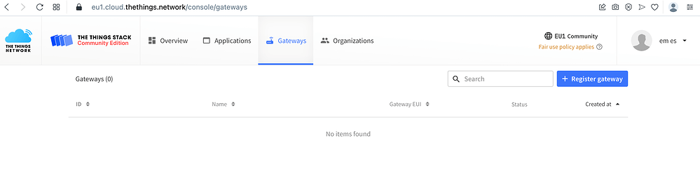

This gateway is currently connected to eu1.cloud.thethings.network and is seeing traffic.
What is your user ID @emxes?
Aren’t they the same as the forum user ids??
Not neccessarily some users have multiple accounts or use an org id for kit and personal id for own interests possibly also seperating users for infrastructure (GW/Servers) & device use and then forum etc.
Always worth checking just in case, I know some vendors and manufacturers do this also ![]()

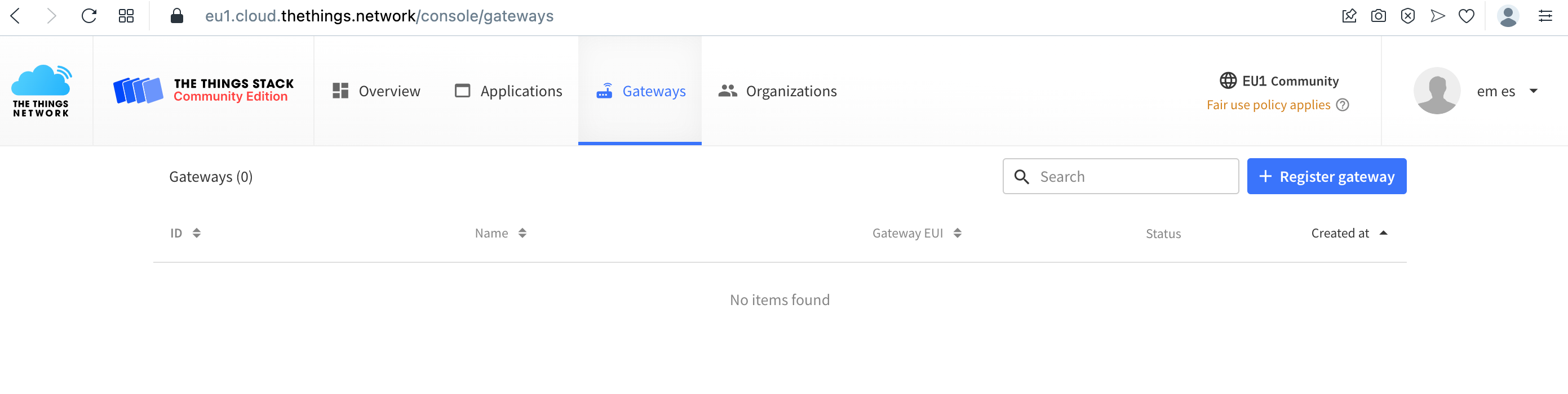

I noticed also that on his/her last post @emxes console icon has user id of em es - space or atleast no x?
Exactly. This gateway is registered under a user emes (without the x). So I’m guessing that this user has multiple accounts and has claimed the gateway under the alternate account.
