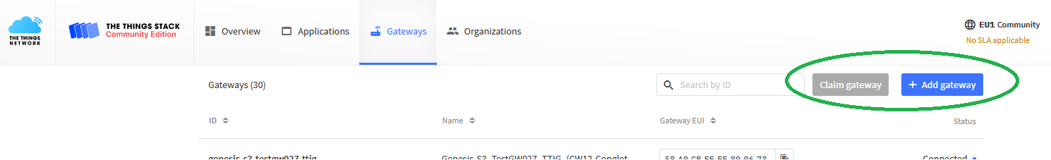

You could try registering it …
… as opposed to claiming it.

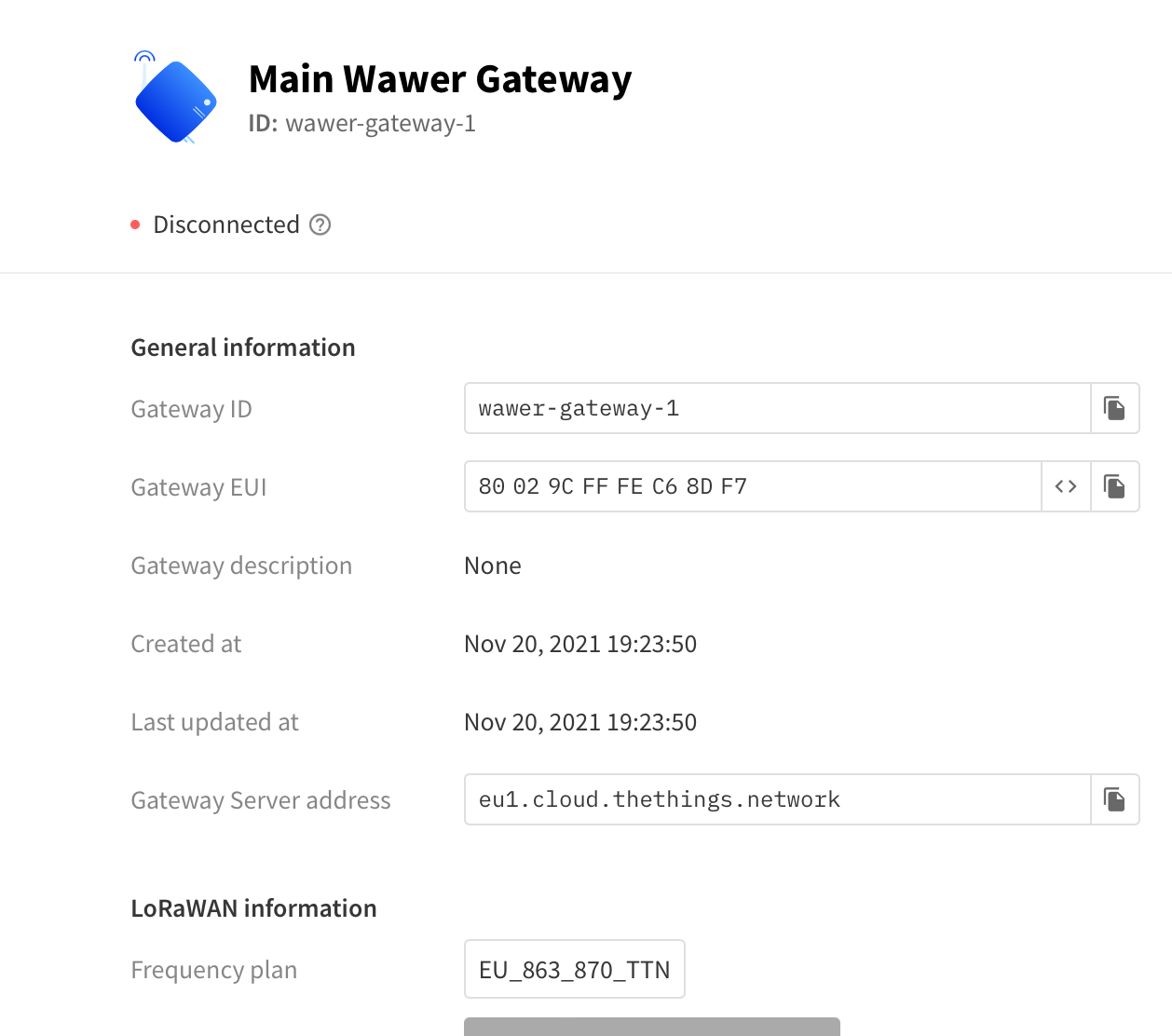

Done, but it still blinks in red (no green light) and is shown as Disconnected:
Zrzut ekranu 2021-11-20 o 19.29.35
As in use the +Add Gateway option (blue radio button) ) vs Claim Gateway (grey radio button) per Nicks suggestion:

Thank you, the last link worked. However, the MiniHub’s LED is solid green (so far configured as a packet forwarder), but the console shows the gateway as disconnected. Why is that?
These are the acid tests - not the on/off indicator which is not updated in absolute realtime but the heart beat messages in the gateway console at the very least.

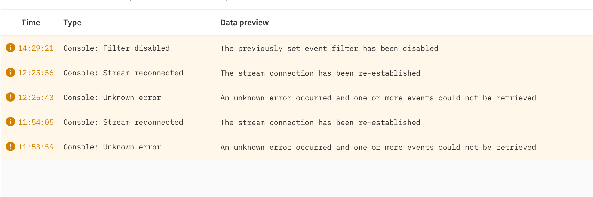

Here is what I am getting in the live data:
Zrzut ekranu 2021-11-21 o 14.29.28
That is probably down to stability of your internet connection and message/session handling between your browser window and the console web page (certainly that is where the “The stream connection…” type messages come in to pplay. Try refreshing your browser window (or try re-opening in new window (not new tab) and if problem persists log out of console and log back in again to start a new session then report back if still seeing an issue… if you have lots of console tabs open at same then it possible that timeout happens more quickly/frequently as session refresh and cookies spread across more tabs/sessions (certainly used to be an issue in V2 console - havent analysed for V3…)
