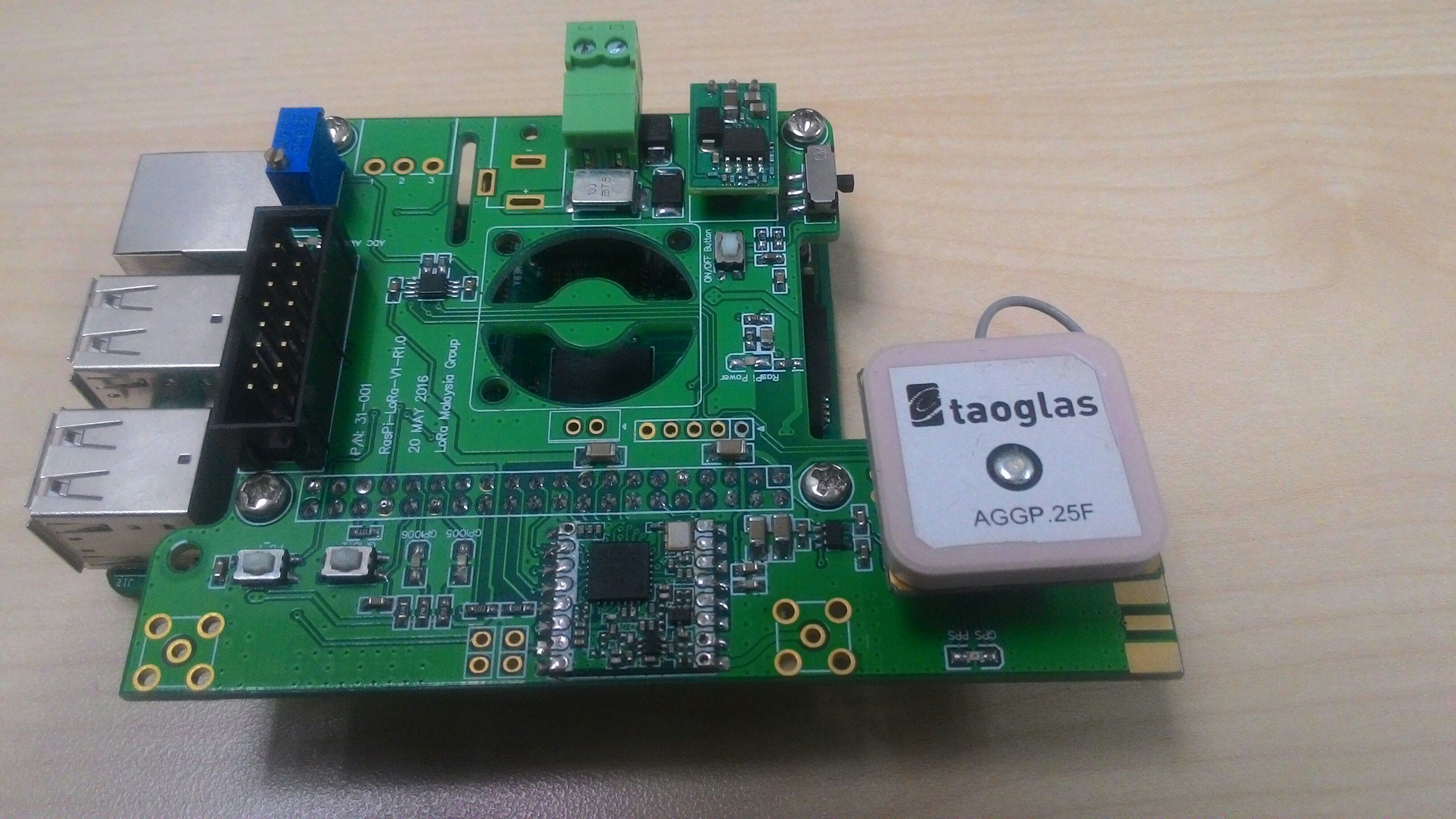

This is my custom raspi hat it has 2 sx1276 and include gps ,adc,i/o expander
I gonna use it for gateway,freq is 433mhz.
In future i wanna dev node using stm32L4 or esp8266 for micro node lora
Nice Raspi Hat you got there!
However in the future in Malaysia, we are going to use spectrum 919 - 923MHz. So you should purchase 915MHz one for RF module.
I am not sure about stm32L4, but I am pretty sure ESP8266 has plenty of libraries and examples for LoRa node in GitHub.
@joehunt588 Glad to see you are back to the forum again. It looked really good! Are you doing dual channels gateway then?

Yup its dual channel ,i use 2 lora combine for mesh network im using TDMA to sync with network,as i dont have sx1301 documentation.anyone have please share really need it
hi @jemie_kb yes 433mhz has interference but the noise you can filter it with antenna or use short datapacket(payload),using 433mhz is good for long range and small packet data(please correct me as i new to LoRa
