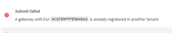

I have a RAK7249 gateway connected to ttn community, I want to connect it to TTI . I have physical access to the gateway and I am the owner and I get the following error

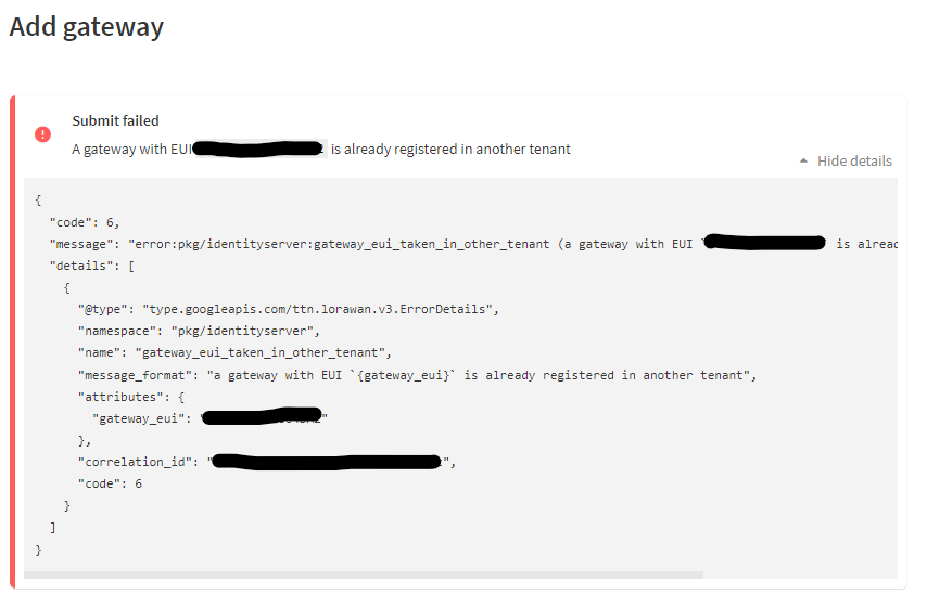

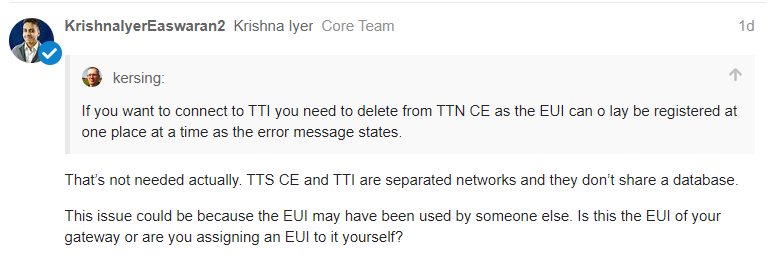

If you want to connect to TTI you need to delete from TTN CE as the EUI can o lay be registered at one place at a time as the error message states.
I already deleted it from TTN CE and when registering it in TTI it keeps sending me the same error
That’s not needed actually. TTS CE and TTI are separated networks and they don’t share a database.
This issue could be because the EUI may have been used by someone else. Is this the EUI of your gateway or are you assigning an EUI to it yourself?
Good to know. Thanks!
@gascadev This EUI was previously registered by a user “AMKIRSCH” someone you know? Same org? May have been under TTN V2 - dont know if that would limit for V3…
Have you typed correctly? (please triple check!)
Update - Original description/name IOTF2-CDMX registered under to US freq plan through US West. Both users are on (fixed?) IP’s under same network - Totalplay.net so guess you guys may know each other!
@AMKIRSCH if not mis-registered 1st time around?

In TTN CE it is already registered without problems. The problem is registering it in TTI. It originated after the V3 update, I have the same problem with 4 other gateways.
gateway EUI
Someone else is using my EUI in TTI?.. “is already registered in another tenant” …
Have you deleted the gateway in TTS(CE)? TTN itself is effectively a Tenant IIRC… (Note once deleted in V3 you wont be able to reuse the Gateway ID if you try to revert)
I did that already. Still the same error
