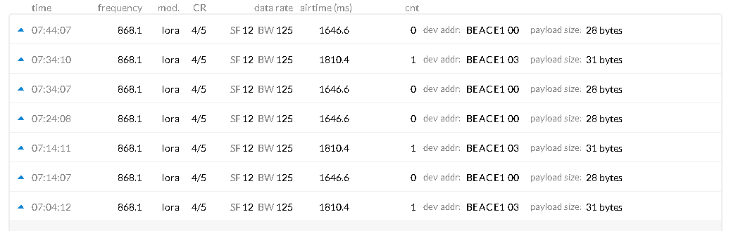

Because of good RF conditions I see both the Amsterdam and Brussels beacon today. :grin:
20180515_BEACE

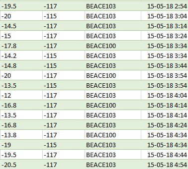

@mvdswaluw: The same near Eindhoven:
TTN%20beaconsl
Time is in UTC, first column SNR, second RSSI.
