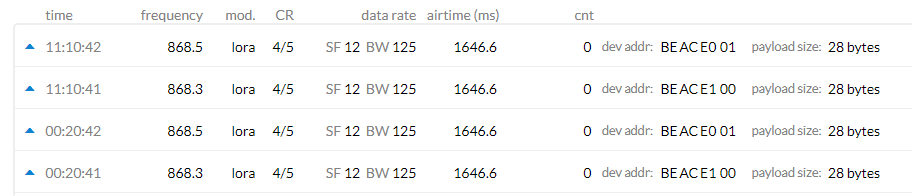

Hi all,
I see on my gateway regular messages coming in from a beacon.
As the title says, whats their purpose, for what can that be used?

that’s discussed before on the forum… but I can’t find it
Apparently this is used by WirelessThings to test if gateways are still up an running, or maybe to do some discovery. Not too nice at all, I feel.
If you copy the actual payloads here, then we can enhance the above list.
for BE AC E1 00
payload: 4000E1ACBE00000000EFA2EDA58E19EE0A7BD56C80015B0CC931B8B1
for BE AC E0 01
payload: 4001E0ACBE00000000FF3FFEAEC4583ABF1BE1A9E555258D3B3FFB3D
just fyi, the beacons are approximately 25km away from my gateway
Eric
So that decodes/decrypts to 4E18A782C05E69CA2759A95E9B4D35 , which decodes to:
$ echo -n 4E18A782C05E69CA2759A95E9B4D35 | xxd -ps -r | base64
ThingsBeaconWalem001
