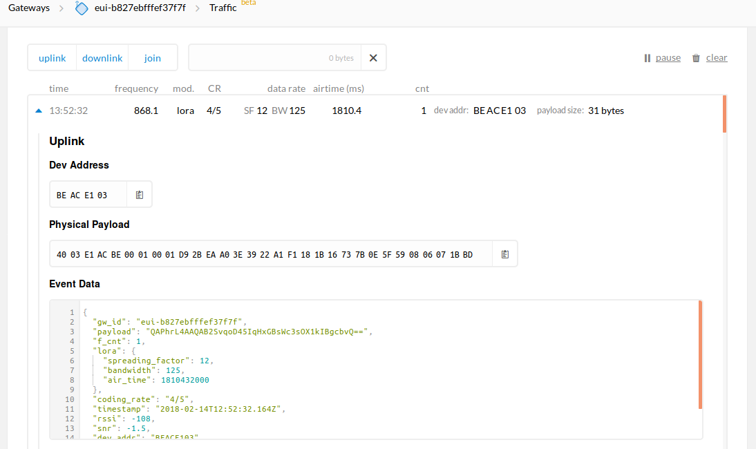

Gateway is receiving the exact same packet for DevAddr "BEACE103" every 10 minutes
Since a few days I’m receiving a packet with identical payload every 10 minutes. It appears to be a valid packet, however the counter is not increasing and remains at 1. Dev addr appears not to be a valid TTN. Anyone has seen something similar?

nope no clues, however looking thru the log of my gateway i count 32606 hits …
I also receive the packer every two minutes.
(as an experiment I have a ~20dB preamp connected and no GPS yet).

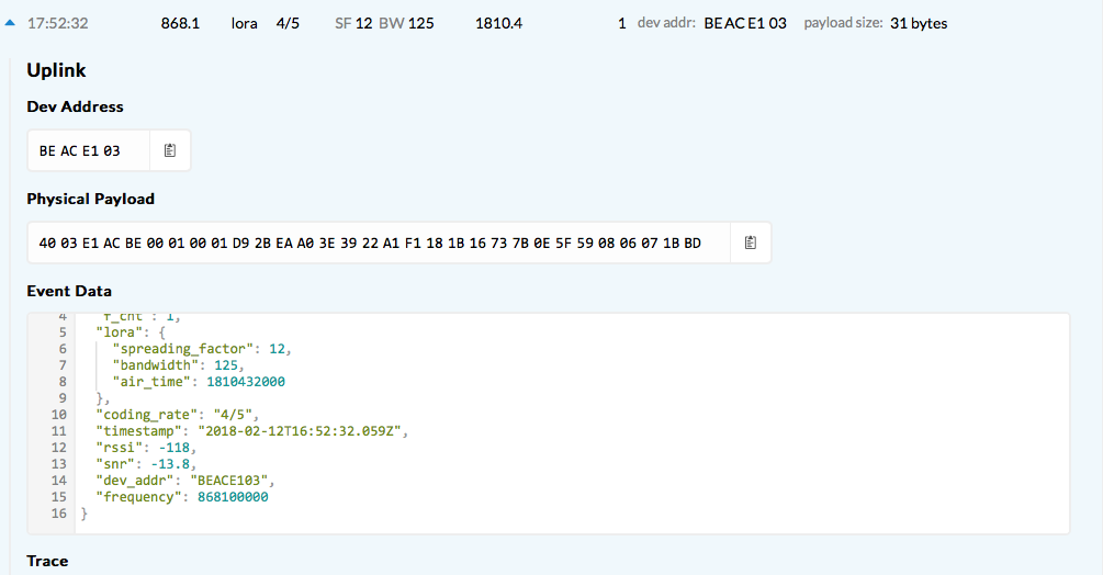

beace103
Have you seen that there also is a new gateway near Amstelhoek (langs de Kromme Mijdrecht) since a few days? Maybe that owner is experimenting.
no have not, where are you located?
Mijdrecht, gateway b827ebfffef37f7f.

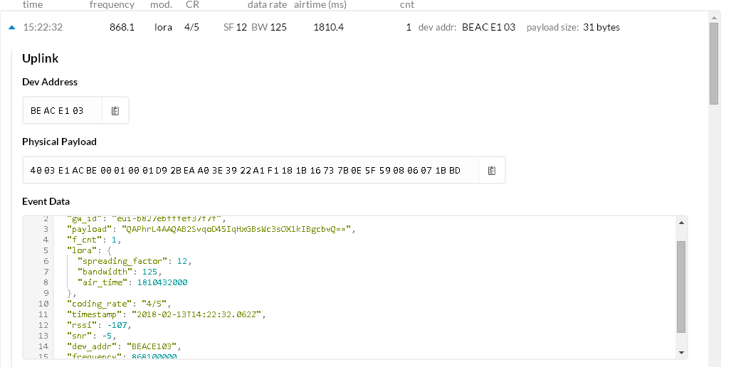

It seems that “BEACE103” now only sends once every 10 minutes.

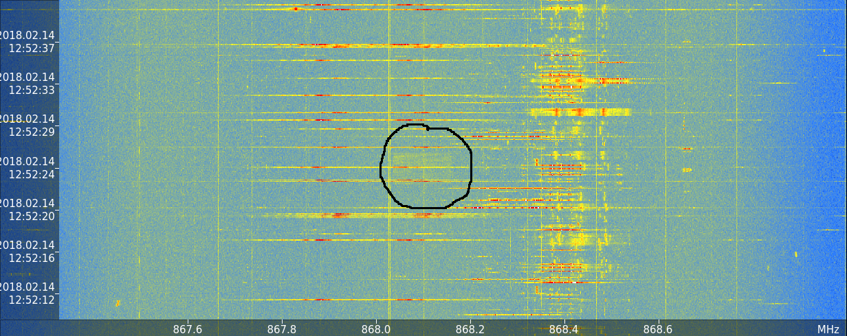

Also managed to capture it with my RTL-SDR-dongle. That is coupled into the antenna via a 3dB coupler and preamplifier. :wink:

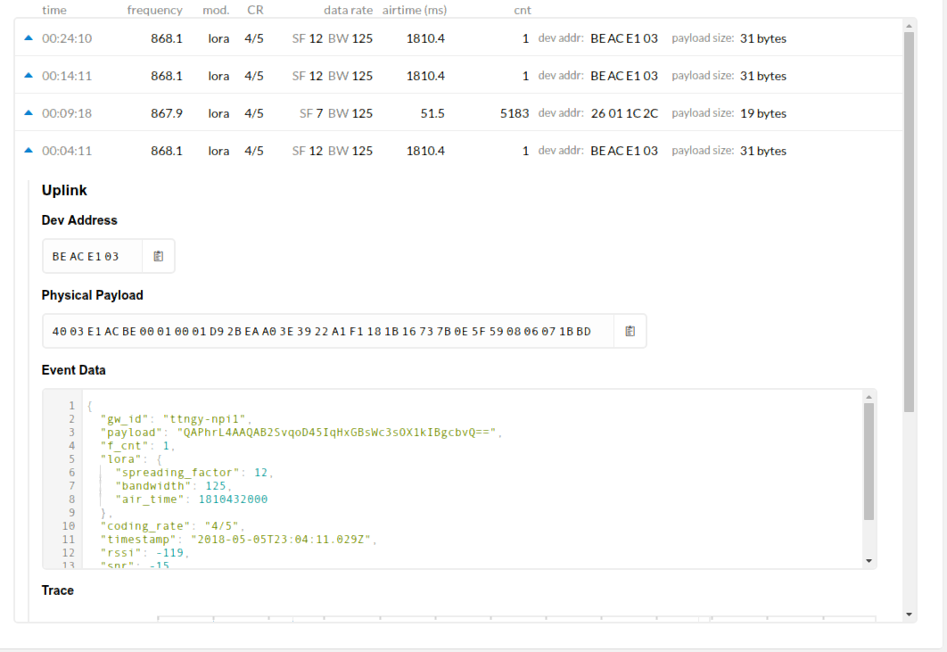

Sorry about posting to an old topic. I was going to create a new but found this on search.
Suddenly it seems one of my gateways is also picking this up now. And at around every 10 minutes.

I have it to sometimes, what you can see is that the node is far away from you, SF 12 , RSSI -119 and SNR -15, also the air_time is ‘enormous’.
I found the weather condition the source of this… sometimes suddenly these far away (or new/other network) nodes can reach your gateway and sometimes not.

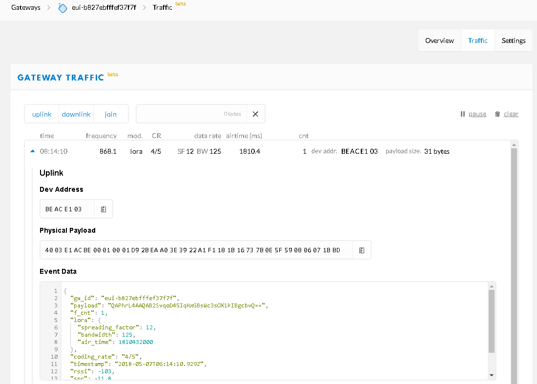

We could compare timestamps if anyone wants to know if this is the very same device. Given that the minutes and seconds almost match the last posts above, it might very wel be. Last packets I got, all at 868.1 MHz:
  • 06:34:11, rssi: -114, snr: 1.2
  • 06:44:10, rssi: -114, snr: 1.8
  • 06:54:11, rssi: -114, snr: 1.2
Given that the following decodes to an uplink with a human readable DevAddr, I’m quite sure it’s actually LoRaWAN, not just LoRa, even though we cannot be sure as we cannot validate the MIC.
4003E1ACBE00010001D92BEAA03E3922A1F1181B16737B0E5F590806071BBD
