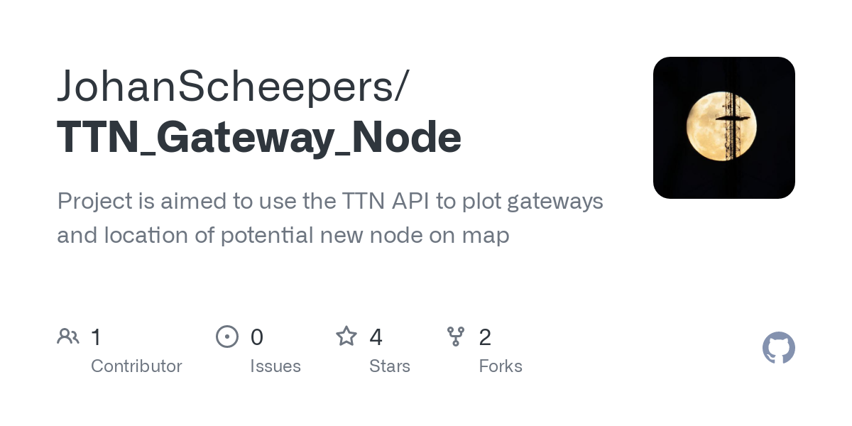

@Johan_Scheepers Looks like the two Github links you posted have since died/changed (gone 404). Could you update please? A bit old but am sure of use to Forumites who might discover in searching for monitoring solutions.
Sorry I only have a commercial version available now.
Monitor gateways and nodes within full notification.
Ok, understood.
Guess re-enforces the message I was told years ago: “if you see something on one of the GIT’s that you ‘think’ might be interesting/useful in the future then if in doubt clone it just in case!” :wink:
Note to other Forumites - if anyone did clone or fork before it was pulled and is able to share (within any applicable licence limits) please let me know.
