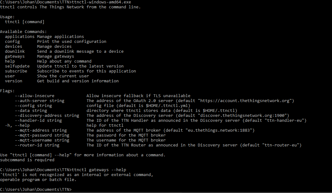

It seems like it does not work on my machine, or am I doing something wrong?

Hi, yes some things are going wrong :wink:
You have to run “.\ttnctl-windows-amd64.exe” instead of “ttnctl” unless you rename it to this file name.
Before you can use ttnctl, you have to register ttnctl: (See: https://www.thethingsnetwork.org/docs/network/cli/api.html)
First get an access code from your TTN profile by going to
https://account.thethingsnetwork.org and clicking "ttnctl access code".
.\ttnctl-windows-amd64.exe user login [paste the access code you requested above]
  INFO Successfully logged in as yourname (your@email.org)
Now you can query the gateway status:
.\ttnctl-windows-amd64.exe gateways status <your_gateway_EUI>

Thank you for your assistance, I mange to fix it and check via CLI that it’s working
