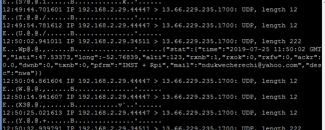

please these are my screen shots
please i am in a fix
I see one CRC_FAIL 100% message in your output. If the node is too close to the gateway (<3 meters), communication can be difficult.
Regarding the gateway no more online, is very difficult to tell something with no information. Is it on, is it connected to the Internet, etc. Try to restart it also.
