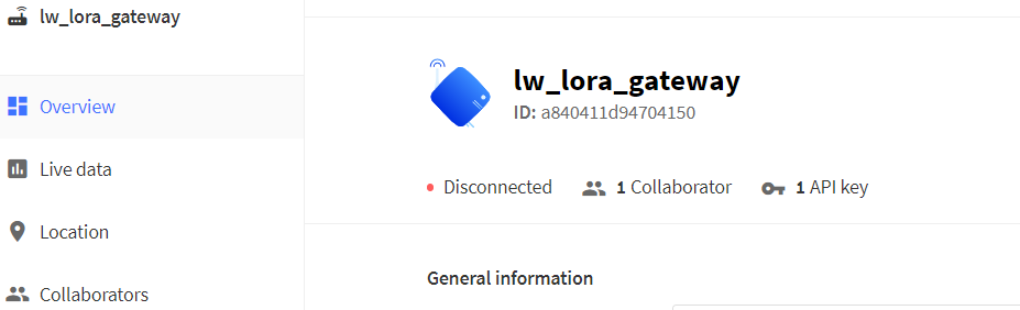

Hi guys,
I have migrated my gateway from V2 to V3 through this guide: Migrating Gateways | The Things Stack for LoRaWAN
However the status still remain “disconnected”
I would like to know if any come across this problem and how you guys solve it. Really appreciate your help!
What does the gateway log say? Is it connected to the internet, the network server, receiving any uplinks?
Thank you for your response. I have solved my problem. I didn’t realise that I was in the wrong cluster, that’s why I couldn’t see my gateway from my end.
