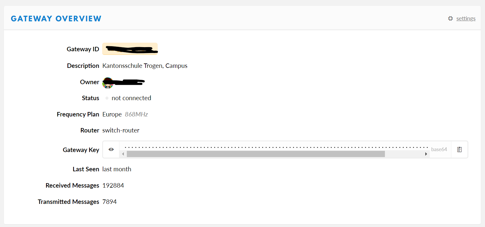

Hello folks,
I write with certain discomfort because it does not seem like anyone cares about this.
It seems some (or all?) of the original kickstarter gateways (TTG) are showing up as offline for a month already! I don’t really know what’s the deal and why nobody seems to care. Is this a general issue? Is it only this gateway somehow? Application data still flows through it.
Cheers
