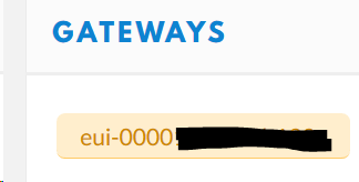

Please add 0000 in your gateway id.
After login in to gateway, you can find the gateway ID under SETTING

in ttn console add 0000 in front of eui and check packet forwarder .I can send some screenshots Monday if required.
