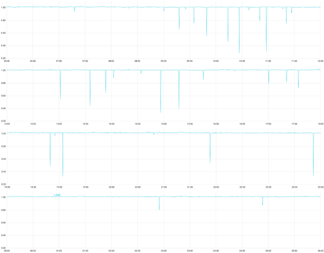

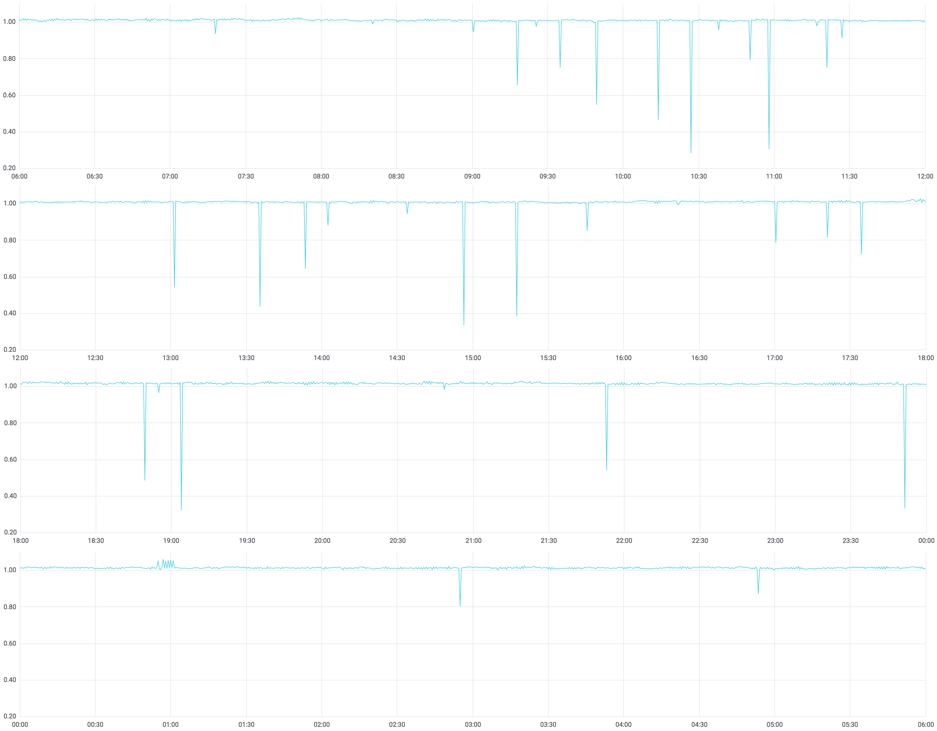

After reporting a few more of those in Slack’s #ops channel, on August 27th @htdvisser wrote:
We’ve had an unusual amount of high-latency periods on the MQTT bridge yesterday. Those typically resolve themselves, and otherwise the bridge should restart itself.
We do not have a fix for this yet, although I have an experiment/sideproject that may be helpful in resolving this
It’s not our highest priority though. This doesn’t happen often enough to become a real problem, and if it happens, it’s usually resolved within minutes
Here’s the Output/Input graph of our MQTT server in front of the EU bridge from yesterday morning until this morning (times are UTC). On the MQTT servers in front of the bridges this metric is typically around 1, meaning that every message that is pushed (by the gateways) to the MQTT server is subsequently pulled (by the bridges). A drop below 1 means that the gateways keep sending uplink, but the bridges can’t keep up anymore (because of those delays).
