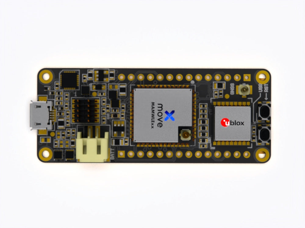

For the node, I have selected the following devices. Depending of dimension and spec, I’ll chose one of the list :
https://www.move-x.it/cicerone-board

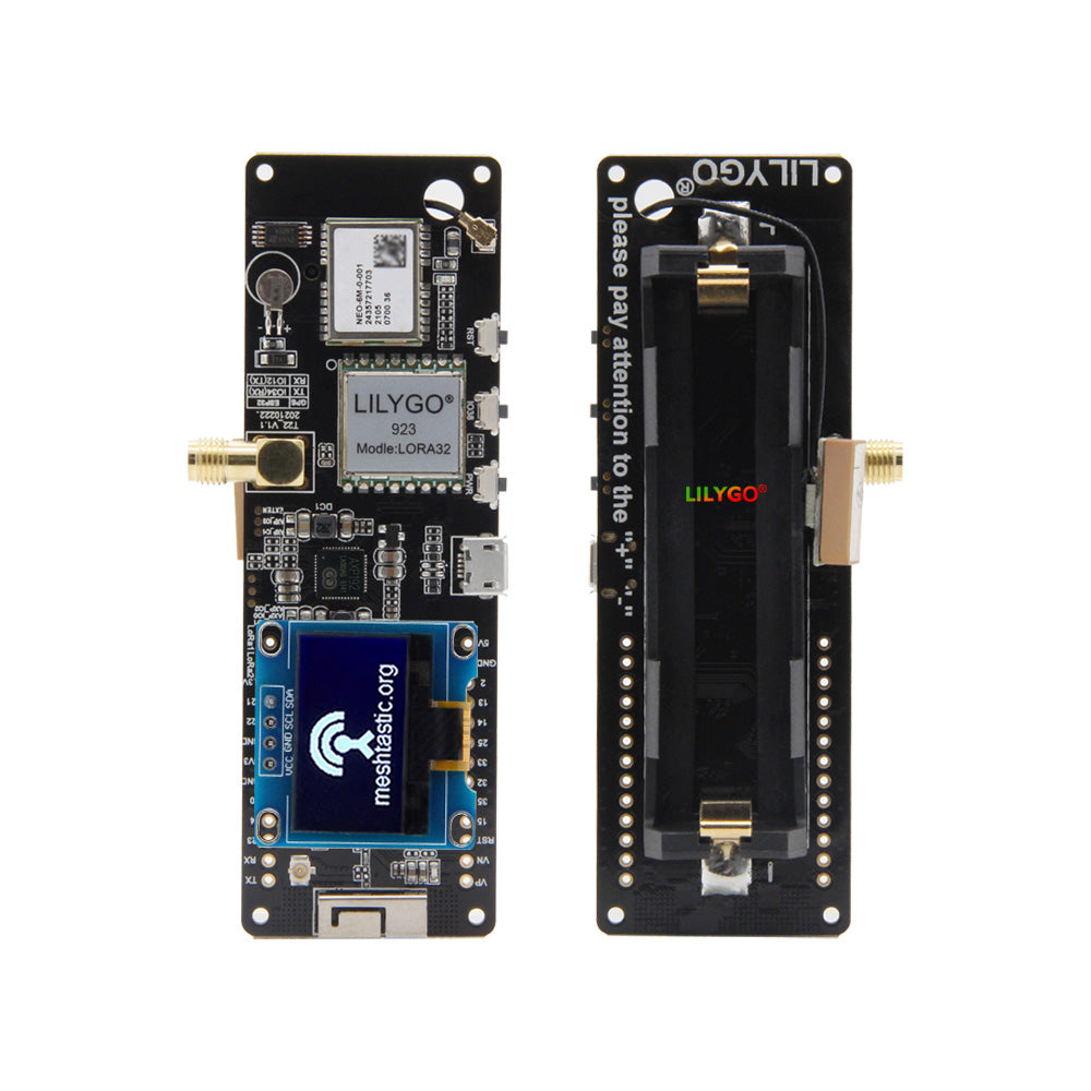

Have four of these on my desk as I’m developing my own tracker / mapper with these. Documentation very poor, hardware quite nice.
Don’t let the “Meshtastic” part get to you - the T-Beam in general is a pretty solid device. The Neo-6M is a bit old but still usable; there are more expensive versions with more modern GNSS receivers. Doesn’t really matter for getting it working though.
They very much try to hide the GNSS part of this; the nRF platform could be nice but a bit of a hassle. No experience, don’t take my word for it.
Looks cool, should be well usable.

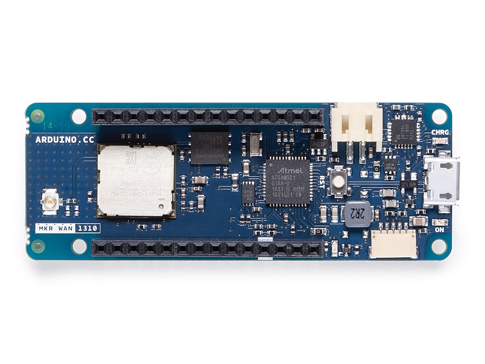

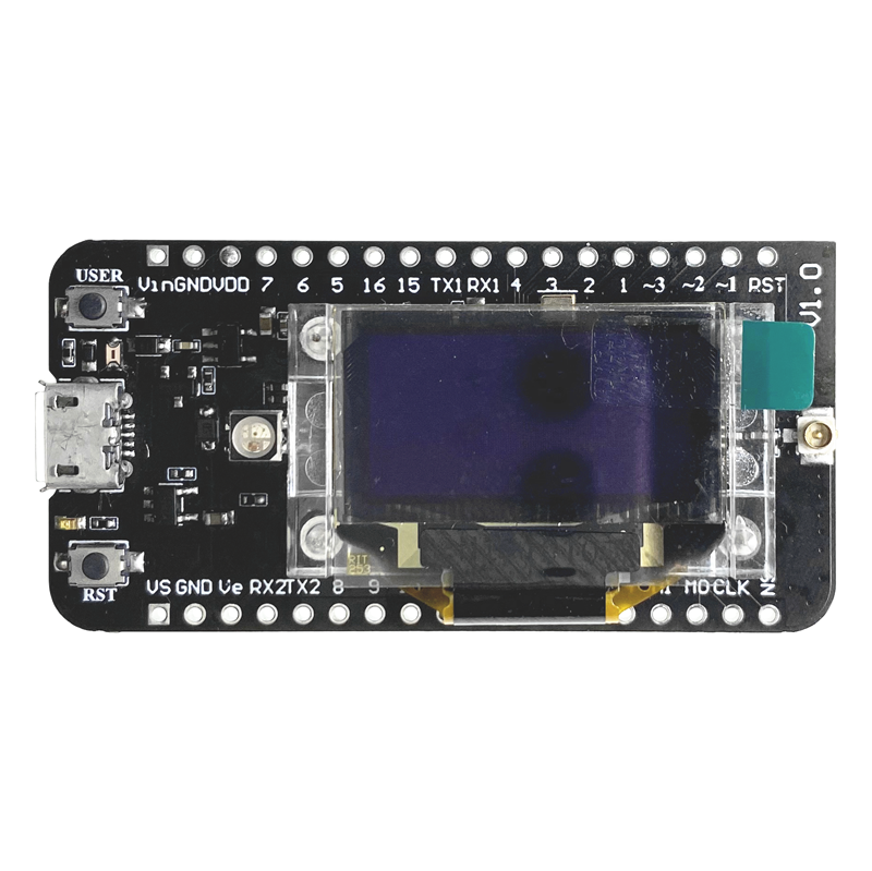

DO NOT - the ASR has many issues that make it tricky for LW
Apart from having to reset the GPS because the Meshtastic firmware turns it off! Otherwise all good.

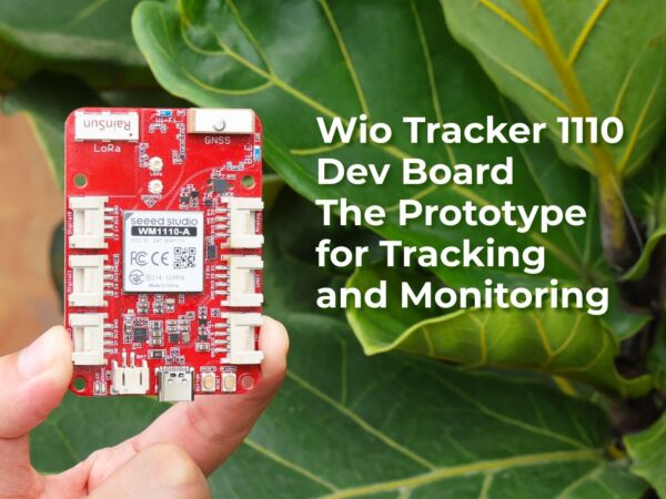

The Wio is a bit big for a tracker and the Arduino is a bit of an unknown entity - neither have come up on the forum so support will be variable.

LILYGOO :
About the “T-Beam Meshtastic”.
I though it can be also used for LoRaWAN. Is this device only for https://meshtastic.org/ ? I suppose it’s a question of FW and can work on both system ? Or is it specific HW for each Network ?
Which Lilygo device is best with better GNSS?
cicerone
Once I have played with Heltec, I’ll check the Cicerone board (Size good)

They promote it to the Meshtastic community and ship it with the firmware pre-loaded. But it is generic hardware that can be used for LoRaWAN - I’ve two on my desk doing that right now - you just write your Arduino program and download it to the board like any other board. If it turns out that the Meshtastic firmware has turned off the GPS, then we can give you the commands to turn it back on.
Lilygo tend to mix & match which GPS module they put on from the u-Blox range but any of them will narrow down where your bike is - if you can get on with a Neo-8M on it, that’s better but it’s not super critical. They don’t do anything with a “better” GNSS module, mostly because “better” is hard to define with so many options that need things like an internet connection or for inertial assist etc.

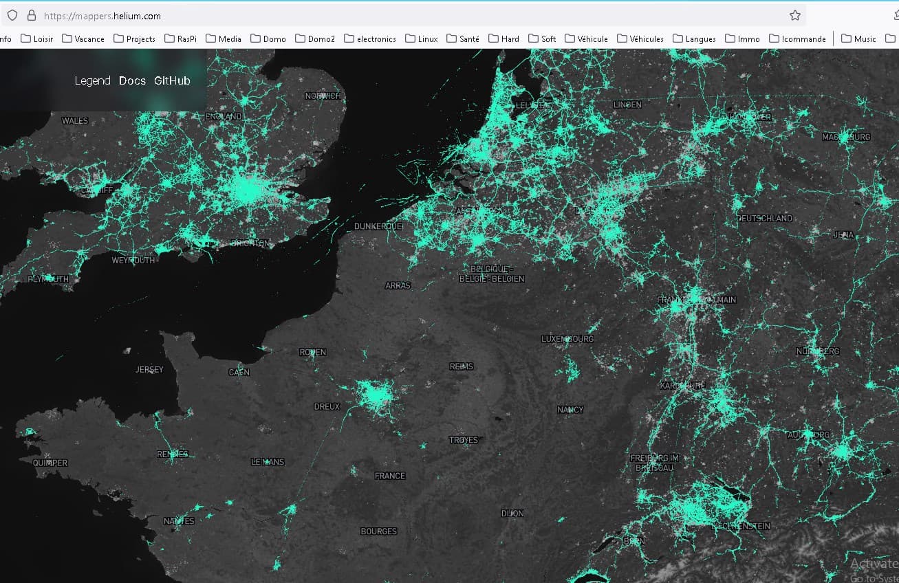

I’m learning now Network providers and gateway
1) About Provider :
I have understood that TTN and Helium have good coverage.
I live in Belgium and currently only the north of Belgium is well covered.
Is it possible for a tracker device to register for two different Network (Helium and TTN) ?
The goal is increase the coverage for a tracker which can move around Europe (stolen bike).

Nope, it’s not. And, as you are likely to use RadioLib, that doesn’t support Helium either. Plus this forum is TTN only, not Helium for which you should look at Helium communities / forum if any of that is still active.
So it’s probably best to get on your bike and cycle around Belgium promoting LoRaWAN and TTN so that people start installing more gateways to improve coverage :grin:
Forum search should provide you with the answer why it can’t be done. So the answer is no.
