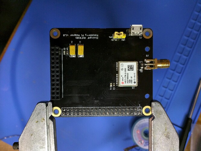

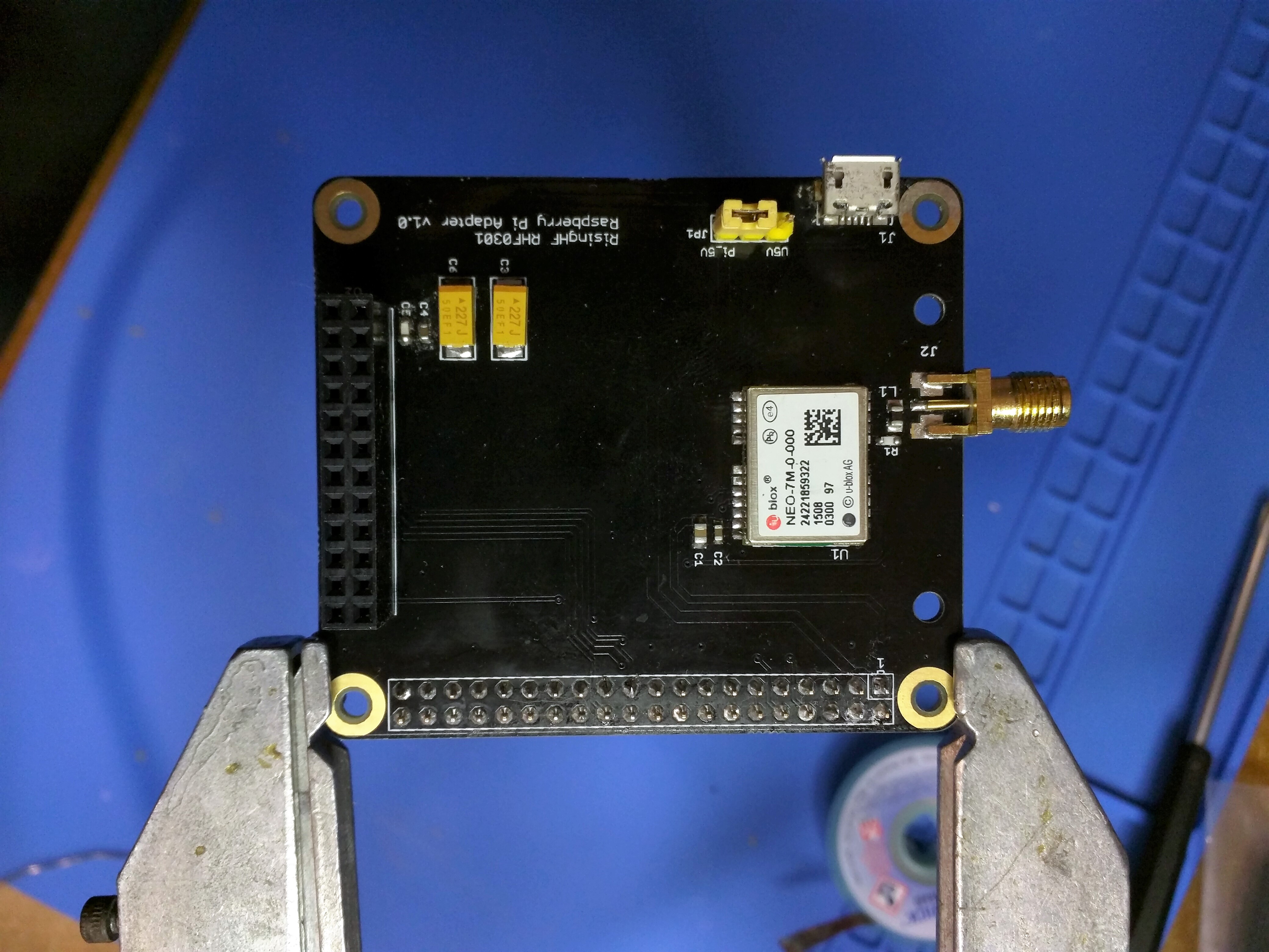

Man this worked awesome for me. I bought the RHF0M301 standalone board last year and have been using jumper wires to bodge the thing together. That was annoying, so I went about looking for the RHF4T002 board only to find that they flat out refuse to sell it except as part of the gateway bundle. Finally ran into this post, had the PCB made, and finally got around to assembling it today. Everything works just like it should! Thanks for taking the effort to design this and then share it with us here!
