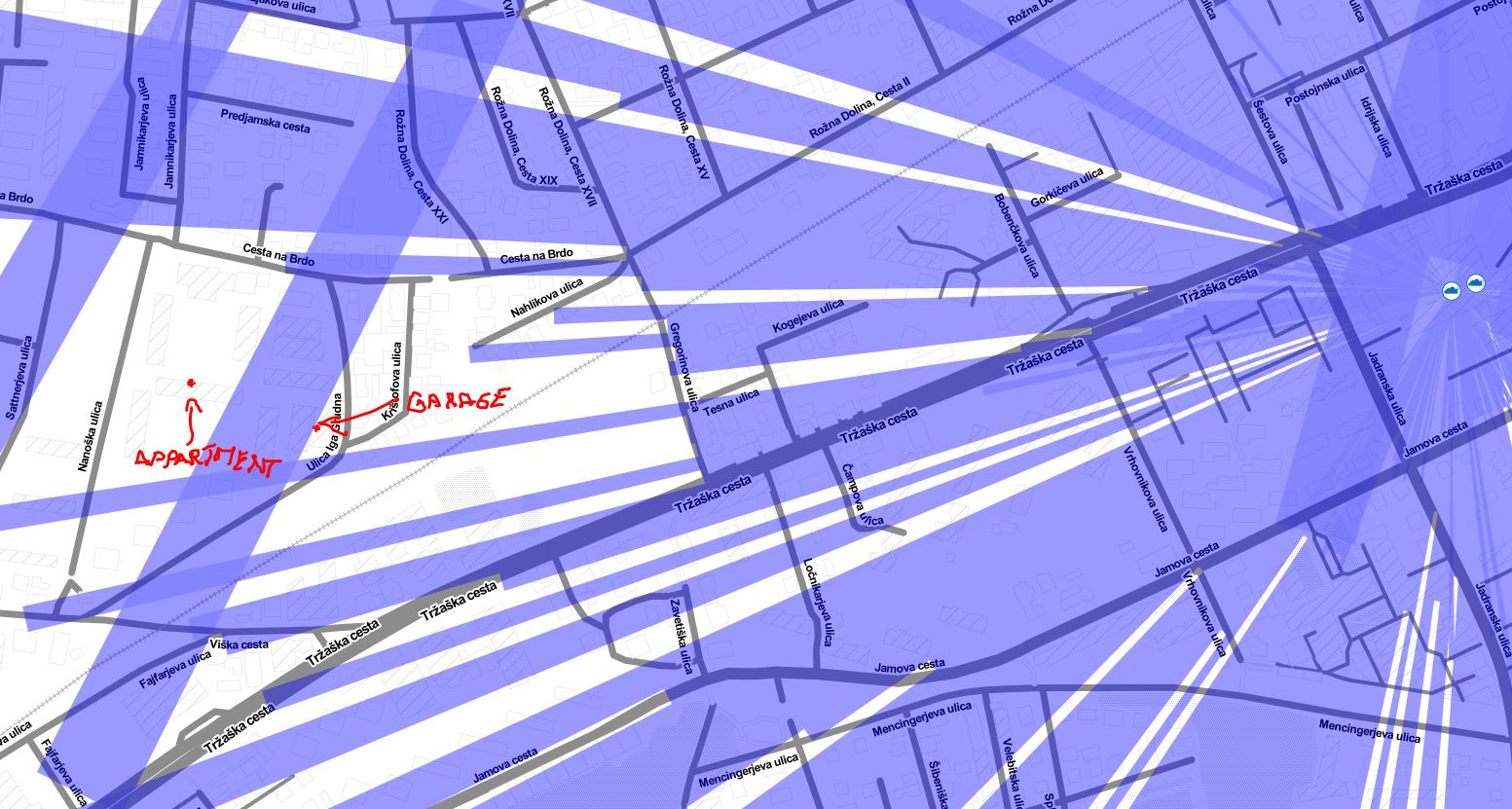

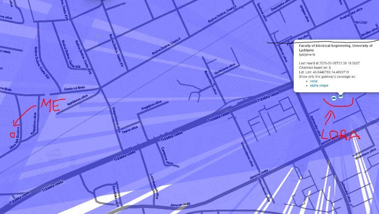

here is screenshot of map, and seems that im covered
lora
If “me” is the place where you have to put the sensor, yes, it seems covered. The only possible issue is that, if your sensor has to be put underground, it might have some difficulty, but try first. By the way, you may also use a good antenna in case.
The node you linked is okay, although you initially spoke about “cheap”. For that price, you may find nodes with enclosure (e.g., https://www.antratek.com/lht65-lorawan-temperature-humidity-sensor ). It also depends on your propension to do it yourself :slight_smile: : if you are interested in temperature and humidity, go with a ready node, if you like tampering, buy pieces and put together (but some programming is needed).Some computer proficiency is needed anyway, to set up the rest.
Note that there’s also a beam from north to south that is drawn over your “me”. That’s a fat line though, indicating that the gateway is far away in the north (and the point at which some data was received is more to the south). Also note that mapping (to create the map) depends on a lot of factors, and often happens outside. If possible then get in touch with your local community. Having a university in town will surely help getting help! :slight_smile:

yes, with “ME” I marked my position. SO im covered!

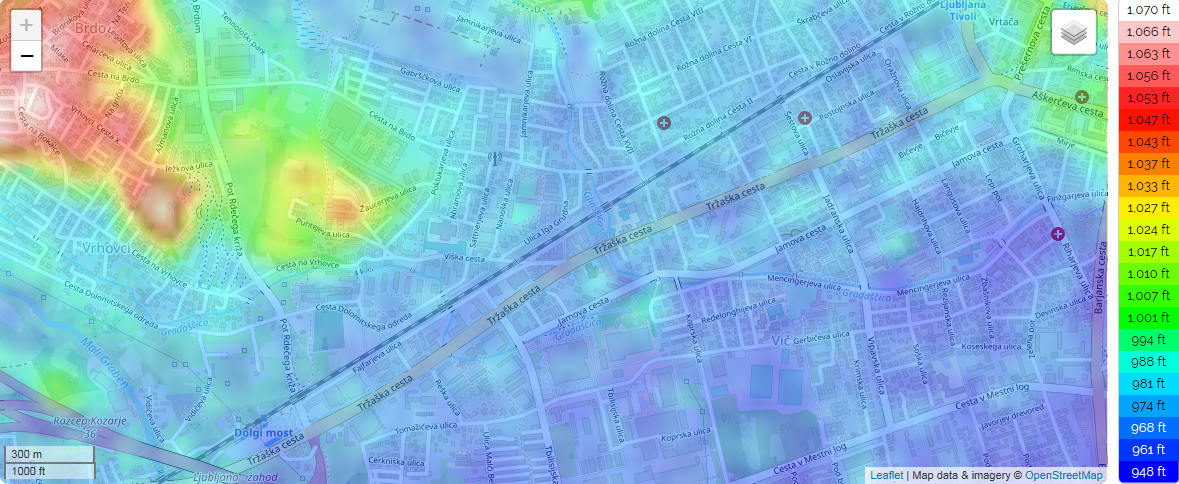

Looking at where you are in Ljubljana the immediate terrain is quite flat in the near neighbourhood so looking at the white space above if you buy yourself a cheap GW (say a TTIG or Dragino LPS8) you will both happily capture node data from the Garage to your apartment but you will also contribute to your local community (https://www.thethingsnetwork.org/community/ljubljana/) & add to local coverage and effectively fill in virtually all the white space on map above if you can place even a few meters high :slight_smile: Though I would have hoped atleast one of the 4 nearest GWs to you would have given some coverage (Though Console shows one to S/S.E is currently offline), it may be that in flat regions with urban development you are just a few hundred meters too far away…

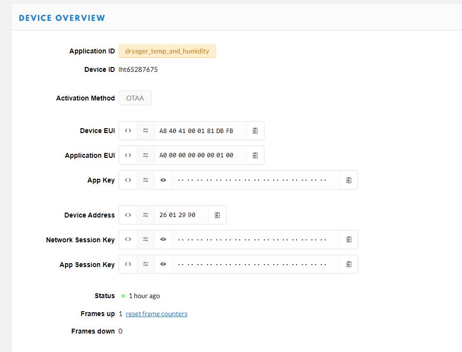

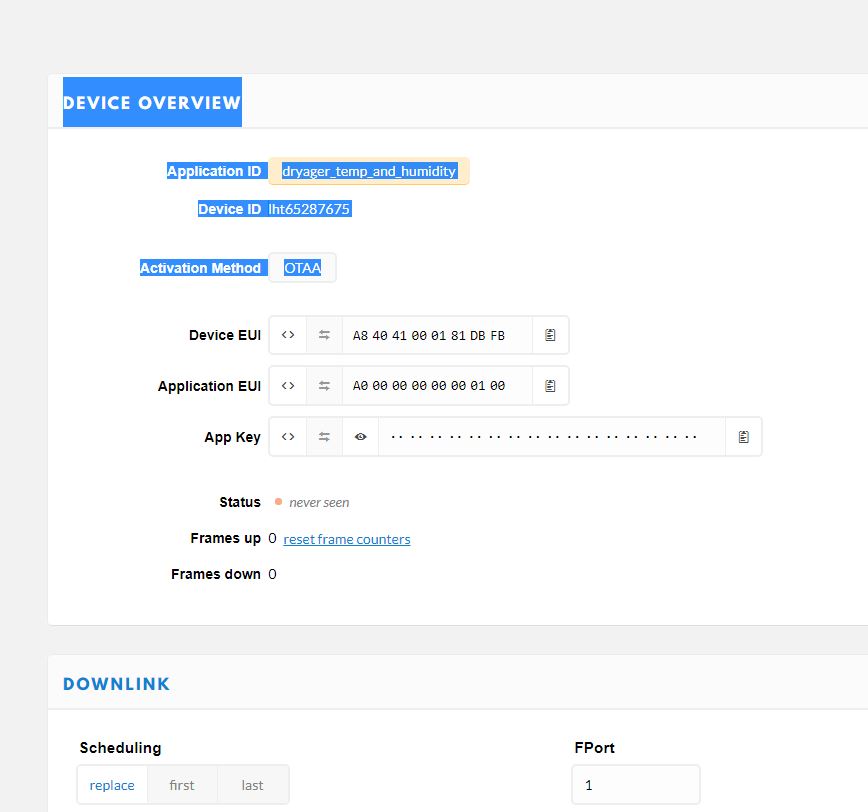

my settings are like this , i attached picture. Dev aDDR, Dev EUI, App Eui, App key, Appskey, NetsKey are printed on the sensor box. So I entered this.
Is it ABP or OTAA? I dont know…
Capture1
Looks like OTAA based on the screen shots but it’s not the clearest documentation!
The manual you linked to says:
2.2 How it works?
The LHT65 is configured as LoRaWAN OTAA Class A mode by default.
So, OTAA it is, for which you’ll have copied AppEUI, DevEUI and AppKey into TTN Console. Geheimtipp: type each value twice on separate lines in some text editor, to easily visually validate you did not make any typing errors. More details in Registration of node with pre-configured LoRaWAN keys - #2 by arjanvanb, but I guess you did right. So, for OTAA, you should not have used the other values anywhere in TTN Console.

As for coverage: remember that TTN Mapper really only shows the results of people who explicitly go outside to do the mapping. Maps of a single gateway will show clickable markers that tell you some more. Like this shows someone was mapping close by in December 2019, but maybe simply not much nearby mapping was done:

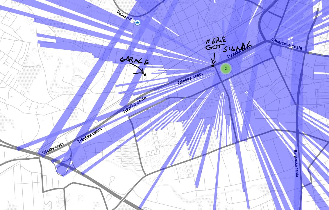

HEllo, As you said, I tried.

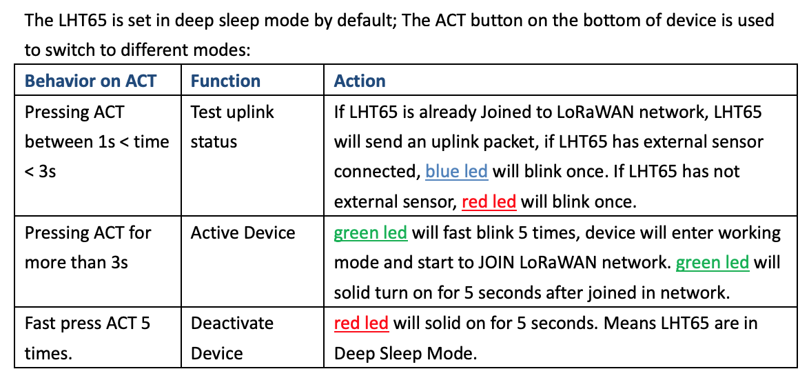

I went closer and closer to the gateway and on some poit, after holding act jey between 1 and 3 seconds I saw blue led blnking on the sensor. And evn on ttn console it changed status to green and showed actual time. So, i guess everything is fine and working.
If Im honest, im disapointed. About this “long range” distances. You must go 200 meters from the gatewaay, and nothing between thay you find signal.
So now, i guess that i have to spent more money for gateway. For this money, I could buy a sim card and have one old phone with data connected for year or two…
Any way, Which gateway you suggest ?

And you will find a great many instances on the forum of node to Gateway distances many times further than that.
So the question really is, since we know LoRa does perform well at long distances, what is the problem with your setup that gives you such a short distance ?
To activate on TTN first, I think you should have pressed the ACT button for more than 3 seconds. Before activation, uplinks will indeed not have worked. But okay, meanwhile it has somehow activated, and “Status: never seen” changed into some time. So, assuming the manual is correct, I guess you pressed the button a bit longer during at least one test?
Beware: pressing that ACT button for more than 3 seconds might make it activate again. This may invalidate the earlier successful activation, while a new activation may fail if reception is bad. So, don’t activate again if there’s no good reason for that.
Once activated, a blue LED only indicates the device has transmitted; it does not know if any gateway also received its transmission from its current position.
Next thing to investigate: at what data rate did the device connect? And are uplinks indeed received from your garage? Given the instructions from the manual, I’d say:
  • Open the TTN Console application’s or device’s Data page on your mobile phone (this needs to be open during your tests)
  • Press the ACT button for a bit more than 1 second (but surely less than 3 seconds)

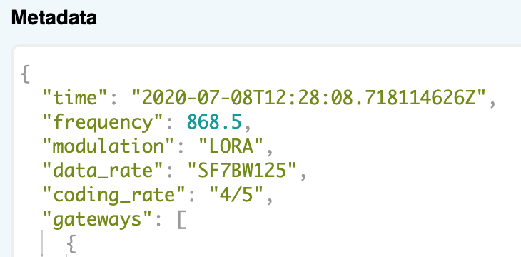

  • If the gateway receives the test uplink, then clicking an item in TTN Console will show you what data rate (Spreading Factor and bandwidth, like “SF7BW125”) was used:
    metadata
If you’re seeing a fast data rate (like “SF7BW125”) then a slower data rate may increase its reach. If it’s a slow data rate (like “SF12BW125”) when outside, but no uplink is received when inside, then you’re probably out of luck if things do not work from your garage.

It depends. If you find that it joined on a fast data rate (like SF7) then its range will be limited. So, it may work close to that gateway, but not in other places. Now, assuming the device has ADR enabled, then after a lot of failed uplinks (96 messages) it may lower its data rate by one step and try again (for another 32 messages), and so on. Hopefully, at some point it will succeed. But that will take a long time. In such case, it might be better to re-join, so the device may start afresh with a slower data rate. (During an OTAA join, many devices will lower the data rate until the Join Accept is received. That will also take time. But not a whopping 96 messages. I don’t know the device you’re using though.)
But, in your case, you don’t know what data rate it’s currently using. So, first doing some investigation while you know it’s still activated, may help.

…or just go on some nearby wide road, to avoid buildings from interfering too much. Look at that other map I linked to above (though that shows old mapping details). Any red, orange or yellow dot proved to have a good reception some day in the past, so might work with your current settings.
