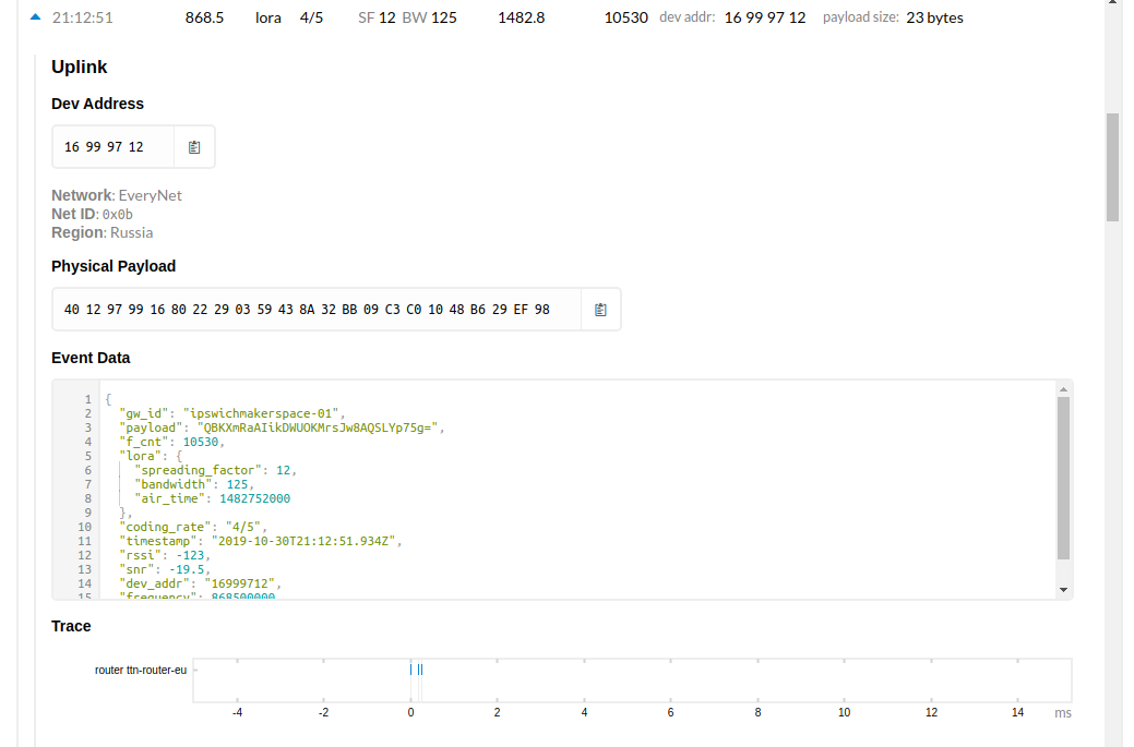

Am watching the A0’s as close to breaking EU duty cycle but just legal and the 16xx is way over as below image
From here, 16 seems more like Russia Everynet.
Thanks, just figured it was EveryNet - didnt realise specifically Russian implementation :slight_smile: Looking at the ID list I was confusing the Net ID and NwkID :wink:

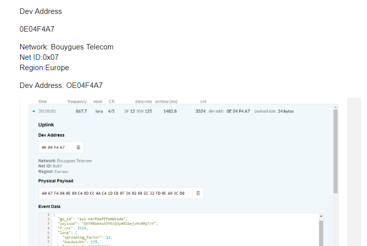

Network: Bouygues Telecom
Net ID:0x07
Region:Europe
Dev Address: OE04F4A7

Bouygues Telecom nodes hitting me in Wales UK, almost look like they are right on top of me going by the RSSI and SNR. They replaced all the street lighting fairly recently… And there looks like a Gateway on one of the lamps.
You may be right - as you ident also from the list and Metada network is Bouygues :wink: Wonder which lighting vendor has done a deal with them :thinking: Am still struggling to ident the A0 devices - may be a private network - loks like typically running at 75-90% of allowed 1% duty cycle - just 'cause they ‘can’ doesn’t mean they ‘should’ - still a bit anti-social running close to the limits continually vs once every so often on a ‘shared’ spectrum…

I can regularly see 30 plus smashing out SF12. Watching the data it appears they have motion sensors inside. As this happens during the day… Everything quietens down a little at night.
I did email the council requesting they turn on ADR.haha. No response.
What does duty cycle look like? Would be embarassing for Council if you had to report to Radio Regulator! :wink:
All 24byte packets at SF12. All very random. Some can go on every second for a few minutes. Then there are pauses. I can’t make much sense of it really. Something triggers them!
It seems Flashnet Intellilight :wink:
:thinking: may well be but thought they (Flashnet) had their own global network Id with devices on Dev Adr 34 xx xx xx? Perhaps leveraging Bouyges’s infrastructure or a local system integrator has done a deal with BT (FR)…
I just found a news from 2015 regarding their cooperation, so not necessarily true.
Could well be as they have co-operations with other telecom companies (e.g. DT) and integrate with lots of LoRaWAN server providers…and with last years large stakeholding from Engie Group likley expanding further…they are into all sorts of network implementations beyond LoRa/LoRaWAN - e.g. NB-IoT & Lonworks etc.

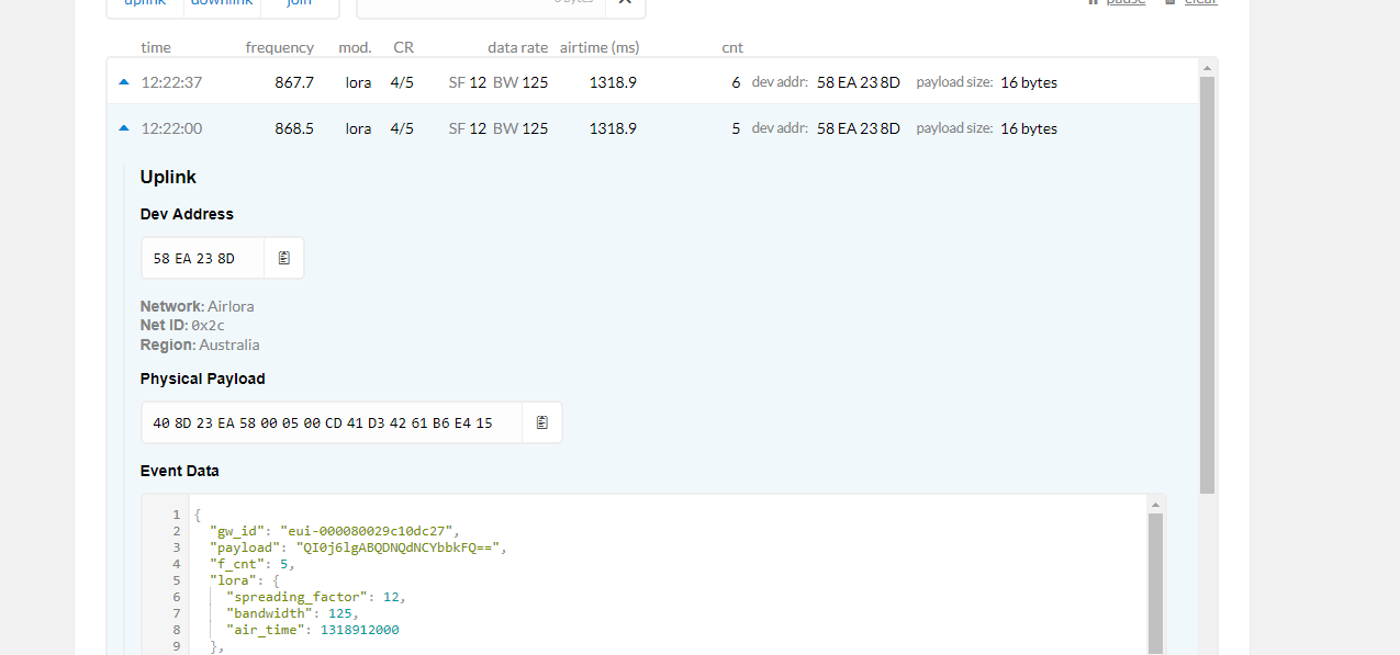

These have sprang up by us today in Newtown, UK. Close to breaking duty cycle.
Airlora Australia?! - WTF! :wink:
Worth reaching out to Justin for info? (Justin Spangaro, Founder and CEO Airlora Communications)
Might be one of the Stratisfi trackers (16 Bytes?) through Spangaro systems? (FYI Justin is ex Ericsson and Ex LSI Logic if I recall, though I dont think I ever met him!)

Just noticed this activity on our Makerspace gateway. Any ideas?
