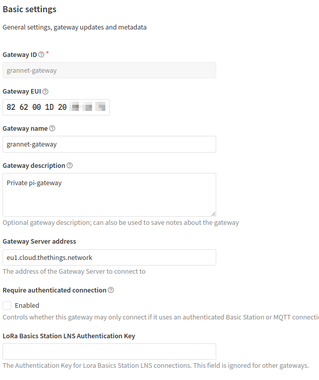

On TTN
2021-08-12_22-29

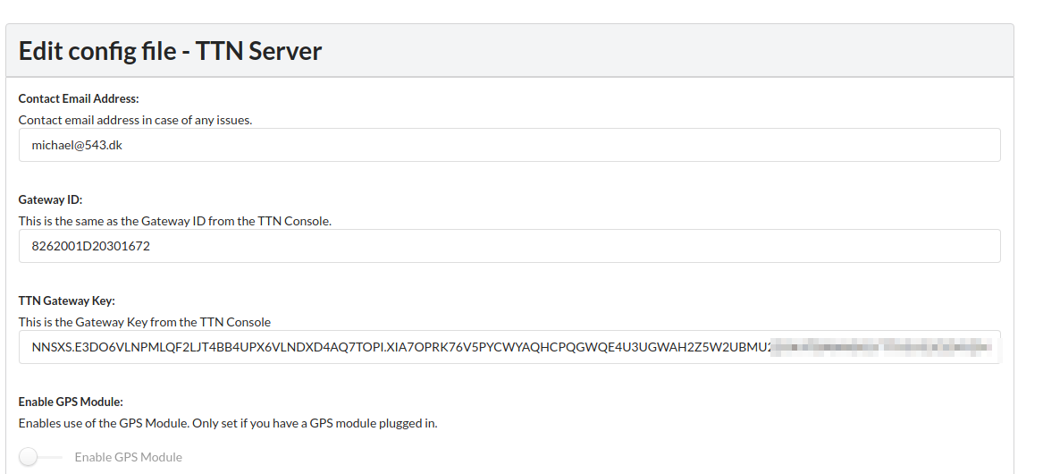

On the gateways config
2021-08-12_22-31

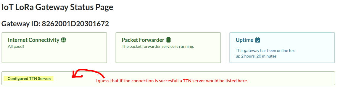

** The gateways status page**
2021-08-12_22-38

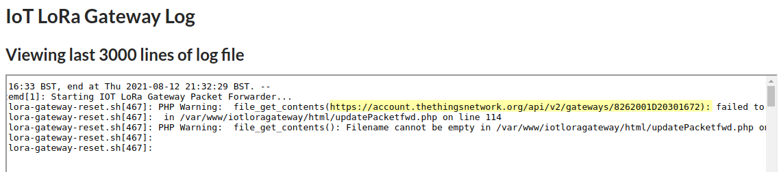

The gateways log
2021-08-12_22-33

Welcome, Michael! Hopefully we can help get you connected. Once you’ve configured your gateway in the Console, there should be a button to Download the global_conf.json file, which makes it easier to configure your gateway settings, because you install/copy it onto the gateway so it knows how to connect.
If your configuration is like mine, you copy the file to /opt/ttn-gateway/packet_forwarder/lora_pkt_fwd/global_conf.json and reboot the gateway. Are you familiar with Linux command-line work (copying files or whatever), or can you upload the configuration through the web interface?
Can you also provide a little more info about how you set up your gateway (a link to a quickstart guide or something similar)? That would help us figure out what your setup looks like.

You’ve described your gateways as “private” in the description box, but there is no such thing.
All gateways on TTN are for public, shared use.
Hi @cslorabox
thanks for helping out.
Yeah you are right the gateway is not private as in no access.
I’ve changed the description a little.
br Michael

I think the problem might be that the gateway is trying to access the v2 protocol. I get this from the gateways logfile.
iot-lora-gateway-reset.sh[449]: PHP Warning:  file_get_contents(https://account.thethingsnetwork.org/api/v2/gateways/8262001D20301672): failed to open stream: HTTP request failed! HTTP/1.1 404 Not Found
iot-lora-gateway-reset.sh[449]:  in /var/www/iotloragateway/html/updatePacketfwd.php on line 114
iot-lora-gateway-reset.sh[449]: PHP Warning:  file_get_contents(): Filename cannot be empty in /var/www/iotloragateway/html/updatePacketfwd.php on line 115
