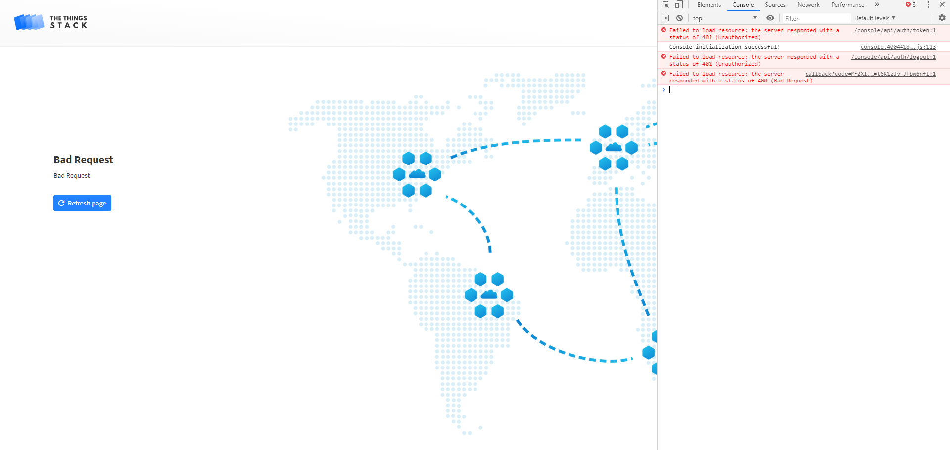

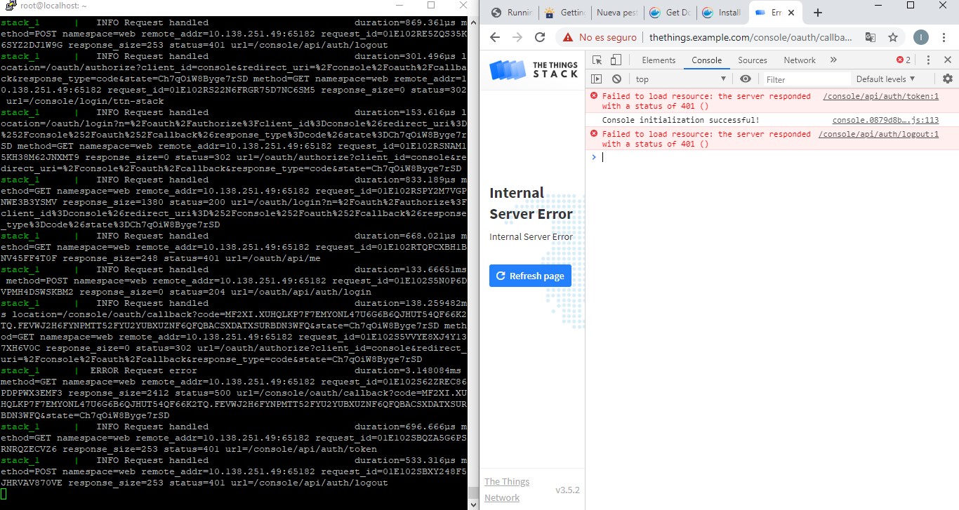

In addition, I leave here a screenshot of my problem in case someone has time to help me.
error

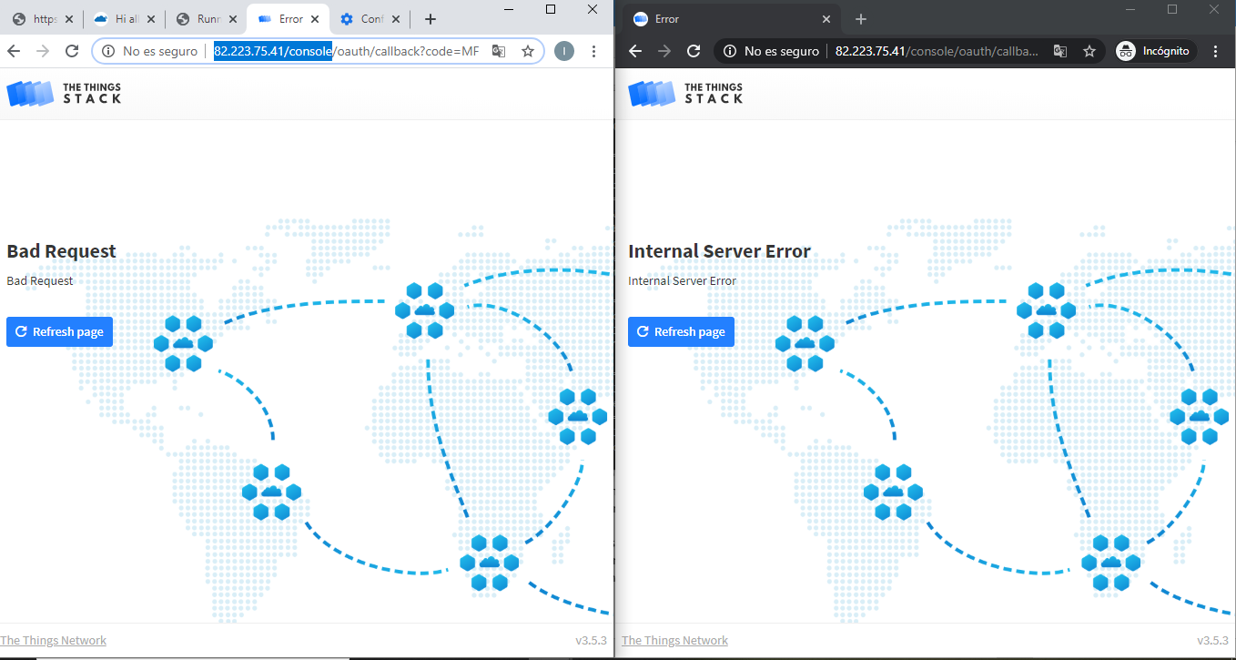

Sorry but I wrote it wrong the previus message, I get a different error “Bad Request”. I’ll try to clear the coockies and cache.
I’ve try it. The left window is right after clearing the cookies and cache. The right one is just in incognito mode. Why are they different errors?
Without looking at what the two different requests actually sends, it is hard to know exactly. But I expect that in your cache there is some old token stored that it is using (for oauth). And in the incognito, it does not use that.
I can only think that there has been some configuration error, try and redo everything from scratch.
