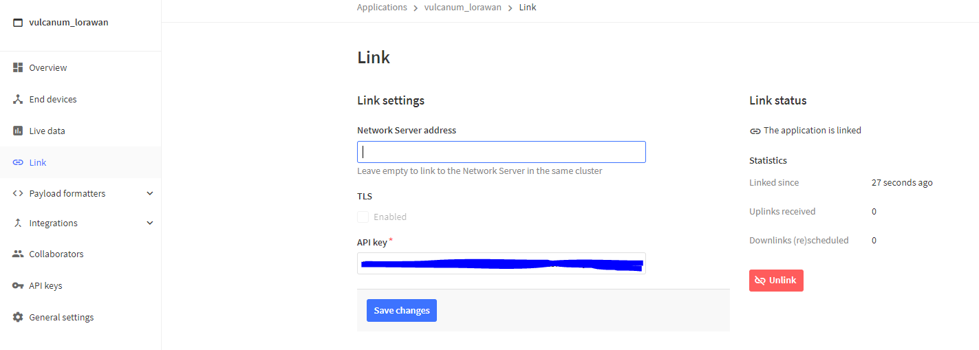

I installed ttn stack v3 on my private server and got everything working, but when I receive something on the gateway, I get the following error:
Host cluster
failed to handle message: No device matches uplink
I already created the application and the end device with matching eui, device addr, network key, app key… I don’t know what is wrong.
Here’s the json with error… Maybe it helps.
