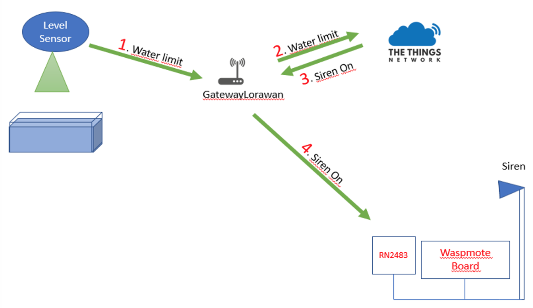

i’m new, so i don’t how to start to do this (link) or which tools of TTN i need to control a siren automatically

but if i need to control a siren for an ews for floods and i have a time around 2:30 hours to send the message and active the siren,
Is it important that you have a high level of reassurance that the flood early warning siren actually does go active when wanted ?
Given your image, see also Monitoring weather, waterlogging and drainage conditions with flood warning in Rio de Janeiro, and its links.
Hi @oscarillo, with 2 hrs 30mins to activate the siren I think that LoRaWAN is perfectly suitable for an application like this.
However I think that your diagram is missing a server behind TTN. If you are going to activate an emergency siren in a public place then you need very solid logic and reliability.
For integration I think that you could use MQTT and your own server in the cloud.
