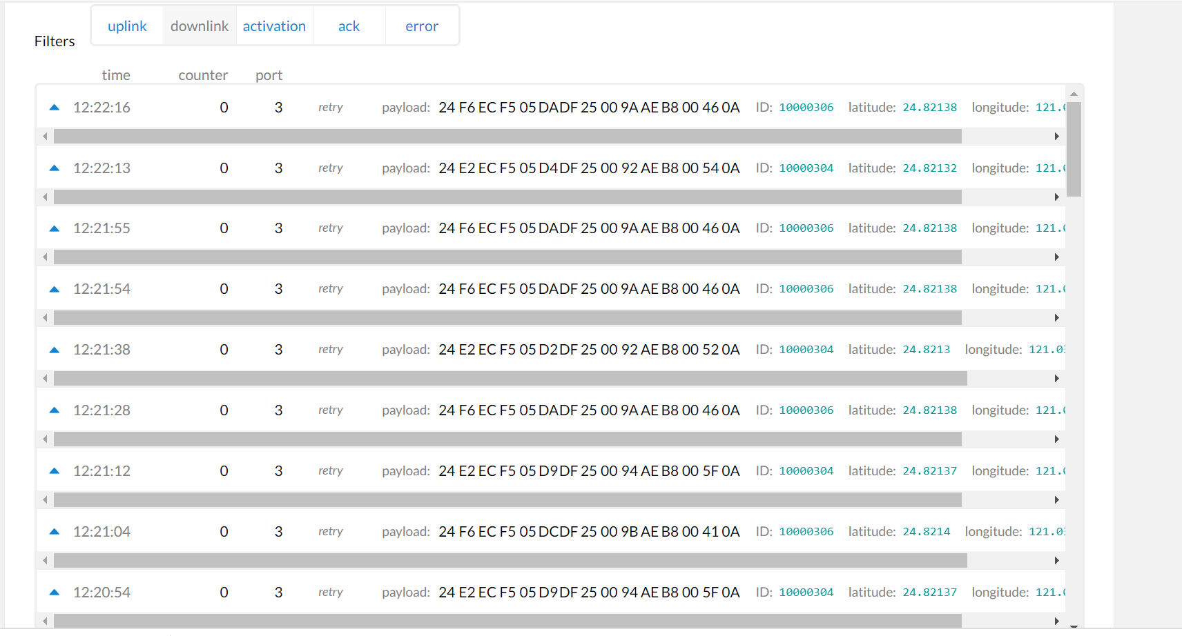

Hello everyone, as the title. Currently, I can see the gateway data in the TTN. I have read a lot of information on TTN, but I still can’t find how to simply save the information to the computer in real-time. How can I do it?
You can’t. The V2 console does not allow you to save the gateway information to your system. Some people seem to have found a way to ‘abuse’ the mechanism used to display the data, however this is not supported and because of the load it places on the console not encouraged.
