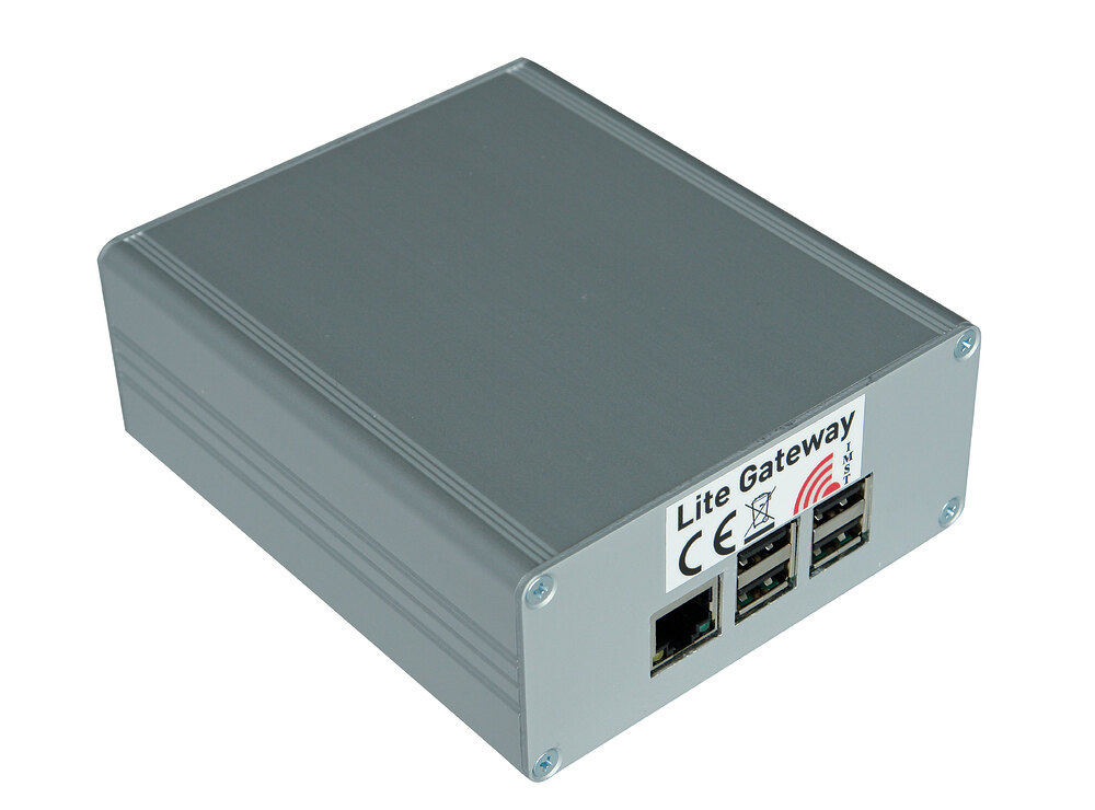

Got a IMST lite-gateway
I was following this guide
And just had to adapt “Reset” to RasPI BCM pin 5 (phys pin 29) (Info supplied by IMST)

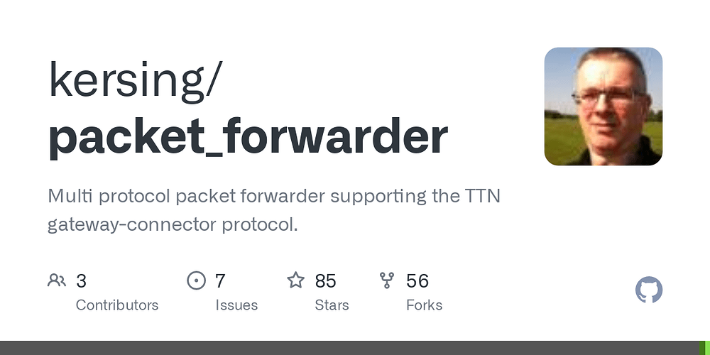

Does anyone have a guide, for how to use the below forwarder instead ?
I’m used to building stuff on linux from source , but need a few hints for the integration of the kersing forwarder , into the ttn-ch build (guide)

You can still use the build script (dev/build.sh) included in the resin.io stuff to build the executable.

This one use the latest @kersing packed forwarder and based on @jpmeijers build script , you can pick up script and get what you need
