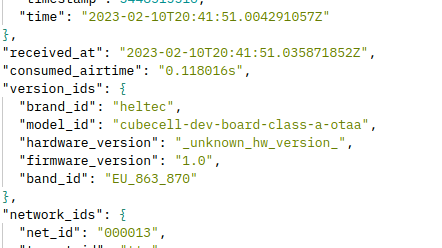

my idea is to make an uplink every 15 minutes with 1byte of data per node. I think that complies with the policy
an uplink takes me 0.118sec, x (24Hx 4 messages/hour) = 11,328 seconds/day. I think I’m not doing anything wrong to anyone

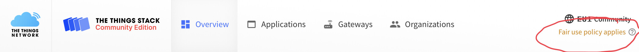

Really?
Check the console:
And
https://www.thethingsnetwork.org/docs/lorawan/duty-cycle/#fair-use-policy
That could be within FUP depending on spreading factor being used (you optimistically assume the best). However you wrote you are currently testing with very different parameters.
How did you figure that timing out?
Not at that guessed timing, but like many other discussions in a similar manner on here, all we ask is that you learn about the technology properly, particularly if you are going to use community servers, which would not be appropriate for 100 nodes, so perhaps best if you talk to @rish1 at TTI about your requirements.
Captura desde 2023-02-10 21-43-02
consumed airtime
