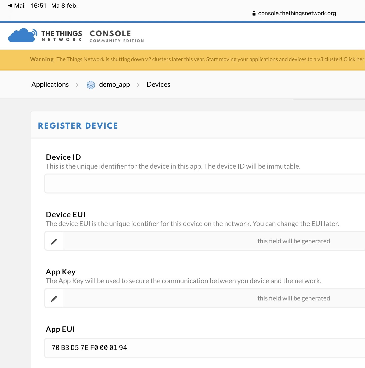

Sorry, in V2 I’m able to have the console generate a DevEUI, note ā€˜this field will be generated’ in the DevEUI field.

Mmm, I guess that getting a valid DevEUI is what most users were expecting (for years already) when they request the V2 Console to generate a DevEUI for their device.
Automatic creation of DevEUI in V2 Console has been the standard procedure for almost all DIY nodes (most use hardware that provides no DevEUI).
