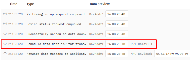

@roman, I tried to reset the MAC but it has no effect.
I executed:
remko@DESKTOP-RLF1S9G:~/ttn-lw-stack$ ./ttn-lw-cli device reset geocaching gc-10 --mac-settings.resets-f-cnt
  "ids": {
    "device_id": "gc-10",
    "application_ids": {
      "application_id": "geocaching"
    "dev_eui": "AF5EE00000009C03",
    "dev_addr": "260B204B"
  "created_at": "2021-02-18T13:27:47.737Z",
  "updated_at": "2021-02-25T20:02:30.933256929Z",
  "mac_settings": {
    "resets_f_cnt": true
The frame counter was reset in console but the downlink for RX1 delay is still scheduled.
afbeelding
I still feel that it is not working.
Can I see ttn-lw-cli device get geocaching gc-10 --mac-settings.rx1-delay --mac-settings.desired-rx1-delay?
And what RX1 delay would you like to use on your device?
