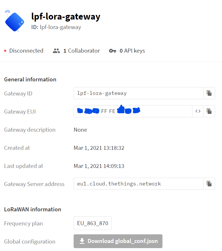

Help please! I am a new user. I have no V2 apps set up. Today I registered the TTN Indoor Gateway successfully on the site but not until later did I realise that that was on the v2 site and we are moving to v3.
I then registered the gateway successfully on v3 site but it showed ‘disconnected’ status. So I then deleted this gateway from the v2 site, leaving it on v3. I also re-booted the gateway. It still shows as disconnected. As a new user I am really struggling to find any clear and basic guidance I can follow.
Attached is a screenshot of my v3 settings. What do I need to do please (in basic terms please!)

Erm, no you didnt - TTIG not yet supported in V3 and needs to be set up and used in V2 1st! (Migration for this to be announced sometime later)

At this point your best option, if now registed in V3 console, it to be patient and wait for the switch-on of TTIG V3 support at which point, hopefully your TTIG will automagically appear in the system or atleast should be recoverable…
In the meantime, though not available to you in the console it may well still be receiving and forwarding messages to the V2 back end and through Packet Broker to V3…do you have functional nodes & applications? If you do you may see traffic coming through if you leave it live (is green led on top on & stable?)…GW EUI will show in message metadata in V2 device/application console or an anonomised version if app in V3 coming through the PB…

So, if I understand what you are saying and what I am seeing correctly, my gateway is in existence on TTN somewhere (V3 or not??) but is not going to be available now until V3 for Gateways goes live?? Do we know when that might be? Oh, and yes the green light is stable on the gateway, and as per my previous, I have no functional nodes and apps. All my LoRa work this far has been non-cloud based i.e. node to node. Thanks in advance for an further guidance.

Your assessment is about right based on my view (on V3) - I think we are looking weeks/months vs qrtrs for go live and expect we will hear more through end of March on timescales.

Sorry for your problems, I guess its now a waiting game (per previous message may still be useable for routing traffic - is it on? Stable Green Led? Seeing traffic routed to your (V2 or V3 apps?), if so you may still be getting the benefit!)
Update: Post just crossed with your 2nd edit where you flag green led on - thats a :+1: so best go get some nodes then :rofl: BTW can you post your GW EUID for ref please?
Thanks for your help. My Gateway has been set to ‘public’ and is showing on the map. Not sure where else I need to post my EUID but it is 58A0CBFFFE8029C5. Happy to post elsewhere if you can tell me where I need to do so. Also recognise the hard work of volunteers in creating documentation etc. Happy to offer myself as a novice proof-reader (to sense check for complete noobs) if that helps you at all?
Always a positive sign :slight_smile: I just looked in the NOC and can see details

So likely you will find that any nodes in your proximity will happily find traffic routed through ok :slight_smile:
