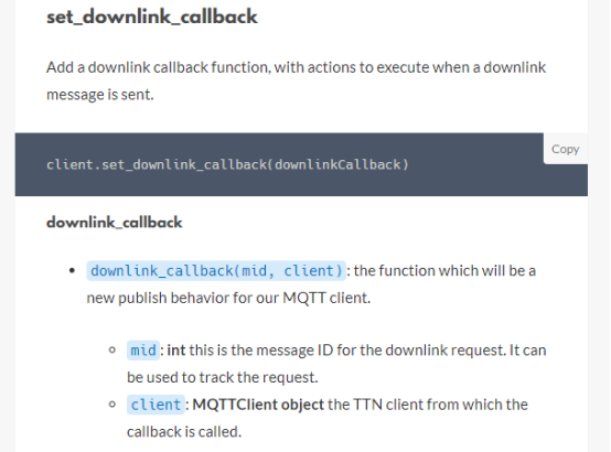

Hello,
I used example on TTN (https://www.thethingsnetwork.org/docs/applications/python/) to build a python SDK to send and receive message. I have successfully received uplink message and stored them. However, I had no idea about how to use codes in this website (https://www.thethingsnetwork.org/docs/applications/python/api-reference.html#send) especially the code following:
In addition, do I need this code to set? And how to use this?

(Bismarck) #3
Thanks a lot! I have worked it out a few days ago. But your suggestion about not using “set_downlink_callback” is very useful.
By the way, have you figured out what is the function of “set_downlink_callback” ? Is it about ACK confirmed?
