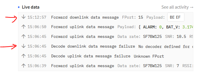

@descartes I’m progressing a bit with my application that schedules a downlink using python. Right now, i can schedule a downlink with following payload:
“frm_payload”:“vu8=”
As provided in the documentation.
And I also see the data arriving:
But what kind of format is vu8=?
I would like to transmit the payload 0x00003C as provided here on page 27: https://www.dragino.com/downloads/downloads/LoRa_End_Node/LDDS75/LoRaWAN_LDDS75_User%20Manual_v1.4.pdf to change the sending interval.
